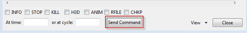

If a simulation is launched in the Altair Compute Console with solver control options checked, the following dialog will appear and a control file will be created automatically using the selected options when the Send Command button is selected.
If the Compute Console (ACC) is not being used, the control file can be created using a text editor and saved in the directory where Radioss is writing the Engine output file.
