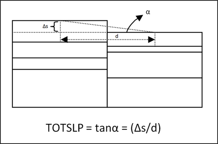

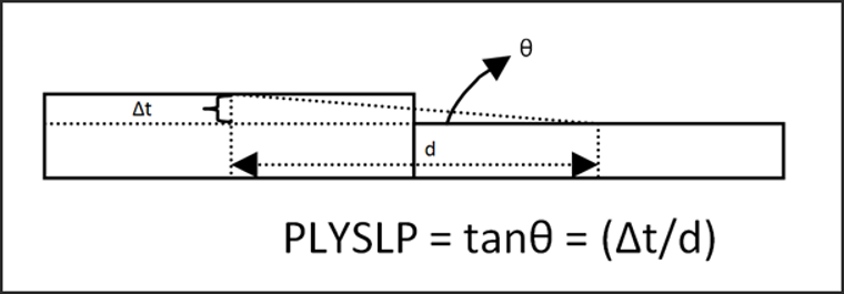

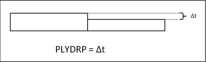

  1. The option for selecting the type of drop-off constraints for PDTYP is defined for a set of plies.
    The PDTYP options are:
    • TOTSLP
    • TOTDRP
      dcomp_stacked_plies
    Assuming that the plies are stacked as Figure 1, the following definition is:
    dcomp_plyslp
    Figure 3.
    dcomp_plydrp
    Figure 4.
    dcomp_totslp
    Figure 5.
    dcomp_totdrp
