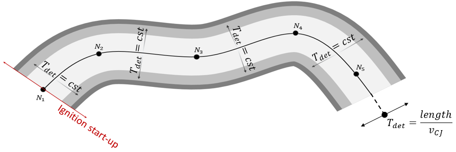

Block Format Keyword Set burning times of explosive material elements along a neutral fiber of detonating cord. Neutral fiber is provided with an ordered group of nodes and numerically built by spline interpolation.

- Catmull-Rom Spline interpolation 1 is used to build the neutral fiber with the provided group of nodes. Centripetal-Catmull-Rom method 2 is chosen because it has several desirable mathematical properties: it prevents from loops, self-intersections, cups, and it follows control points more tightly. 3
- Ignition starts from the cord section which contains the first node and is propagated along the neutral fiber. Each section of the cord is supposed to have the same ignition time depending on its position along the neutral fiber. For each element, centroid is projected on neutral fiber and ignition time is deduced from position along neutral fiber.
- Detonation times are available in the Starter output file (IPRI ≥ 3).
- Burn fractions are available in time history file with /TH/BRIC card and the BFRAC contour output keyword.
- Detonation velocity is taken from the JWL material law. Cord detonation is instantaneous.
