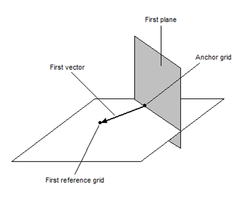

PATRN=0/1, if PATRN=1, read pattern grouping constraint definition: 2
(1) (2) (3) (4) (5) (6) (7) (8) (9) (10)
TYP AID XA YA ZA
FID XF YF ZF
UCYC SID XS YS ZS

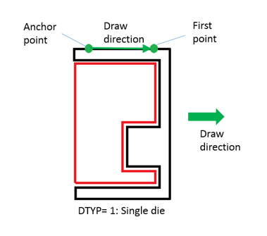

DRAW=0/1, if DRAW=1, read draw direction constraint definition: 5
DTYP DAID XDA YDA ZDA
DFID XDF YDF ZDF
ogrpart NOHOLE TSTAMP

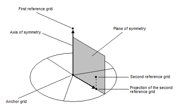

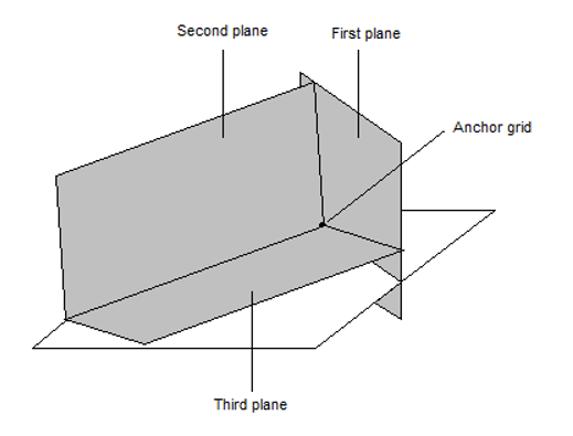

TYP Pattern grouping type requested.
= 1
1-plane symmetry
= 2
2-plane symmetry
= 3
3-plane symmetry
= 10
Cyclic
= 11
Cyclic with symmetry
Default = No pattern grouping (Integer)
AID Anchor node identifier for variable pattern grouping definition.
blank
The XA, YA, and ZA fields should not be blank.
(Integer > 0 or blank)
XA, YA, ZA Coordinates of the pattern grouping anchor point.
blank
AID should not be blank.
(Real or blank)
FID Node identifier used to define the direction of the first vector for variable pattern grouping.
blank
The XF, YF, and ZF fields should not be blank.
XF, YF, ZF Components of the first vector used to define pattern grouping.
blank
FID should not be blank.
(Real or blank)
UCYC Number of cyclic repetitions for cyclical symmetry. This field defines the number of radial "wedges" for cyclical symmetry. The angle of each wedge is computed as 360.0/UCYC.
Default = blank (Integer > 0 or blank)
SID Node identifier of the second point for pattern grouping definition.
blank
The XS, YS, and ZS fields should not be blank.
(Integer or blank)
XS, YS, ZS Coordinates of the second point for pattern grouping definition.
blank
SID should not be blank.
(Real or blank)

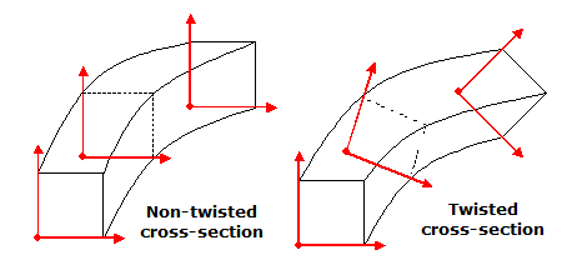

ETYP Extrusion constraint type to be used.
= 0
NOTWIST.
Indicates that the cross-section cannot twist around the neutral axis, in which case only one path needs to be defined.
= 1
TWIST.
Indicates that the cross-section can twist around the neutral axis, in which case two paths need to be defined.
(Integer)
extrGRN1 Node group identifier that defines the primary extrusion path.
(Integer > 0)
extrGRN2 Node group identifier that defines the secondary extrusion path.
If this field is blank, the secondary extrusion path is not specified.
This is only required when ETYP=1 (TWIST) is defined.

DTYP Draw direction constraint type to be used.
= 1
Single die
(Integer)
DAID Node identifier used for the definition of a draw direction anchor point.
blank
The XDA, YDA, and ZDA fields should not be blank.
XDA, YDA, ZDA Coordinates of the draw direction anchor point.
If XDA, YDA, and ZDA are blank, DAID should not be blank.
(Real or blank)
DFID Node identifier for the definition of a draw direction point. The vector is defined from the anchor point to this point.
blank
The XDF, YDF, and ZDF fields should not be blank.
XDF, YDF, ZDF Direction of the vector for draw direction definition. These fields define a point. The vector is defined from the anchor point to this point.
If XDF, YDF, and ZDF are blanks, DFID should not be blank.
(Real or blank)

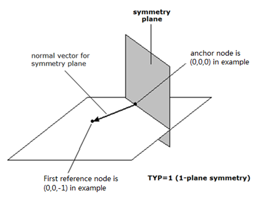

Pattern is activated with TYP=1 (1-plane symmetry)

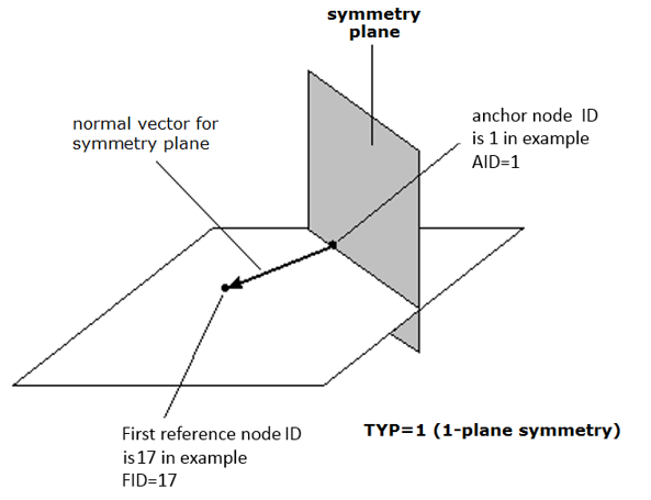

Figure 1. Pattern is activated and use TYP=1 (1-plane symmetry)
dtpl_example
/DTPL/1
grpart 6 for topology optimization
### PATRN=1: active pattern
### TYP= 1: 1-plane symmetry
### AID=1: anchor node ID for variable pattern is 1
### FID=17: Node ID 17 used to define the direction of the first vector
#grpart_ID      TMIN    STRESS   MEMBSIZ     PATRN    PATREP      EXTR      MESH      DRAW
         6                                       1
#      TYP       AID                  XA                  YA                  ZA
         1         1
#                FID                  XF                  YF                  ZF
                  17
#     UCYC       SID                  XS                  YS                  ZS

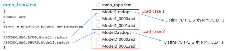

Example (MMODIC)
Draw and MMOCID is activated with TYP=1 (1-plane symmetry).
dtpl_example_mmocid
Figure 3.
dtpl_example_mmo_topo
/DTPL/1
grpart 1 for topology optimization
### MEMBSIZ=1: active member size control
### DRAW=1: active draw/casting direction constraint
### MMOCID=1: active Skew identifier flag for mapping the design domains in Multi-Model Optimization
### minimum diameter of members MINDIM=40 and maximum diameter of members MAXDIM=80
### Normal vector is from Anchor node (XA,YA,ZA) to First node (XF,YF,ZF)
### MCID=1: Skew identifier 1 used for mapping the design domains in Multi-Model Optimization
#grpart_ID      TMIN    STRESS   MEMBSIZ     PATRN    PATREP      EXTR      MESH      DRAW    MMOCID
         1                             1                                                 1         1
#             MINDIM              MAXDIM               MINGAP
                  40                  80
#      TYP       AID                  XA                  YA                  ZA
