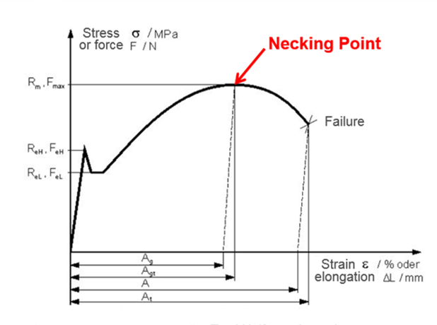

In this Force-elongation curve or engineer stress-strain curve, three points are important.
  1. Yield point: where material begin to yield. Before yield you can assume material is in elastic state (the Young's modulus E could be measured) and after yield, material plastic strain which is non-reversible.
    • Some material in this test will first reach the upper yield point (ReH) and then drop to the lower yield point (ReL). In engineer stress-strain curve, lower yield stress (conservative value) could be taken.
    • Some material can not easily find yield point. Take the stress of 0.1 or 0.2% plastic strain as yield stress.
  2. Necking point: where the material reaches the maximum stress in engineer stress-strain curve. After this point, the material begins to soften.
  3. Failure point: where material failed.
Rm
Maximum resistance
Fmax
Maximum force
ReH
Upper yield level
ReL
Lower yield level
Ag
Uniform elongation
Agt
Total uniform elongation
At
Total failure strain

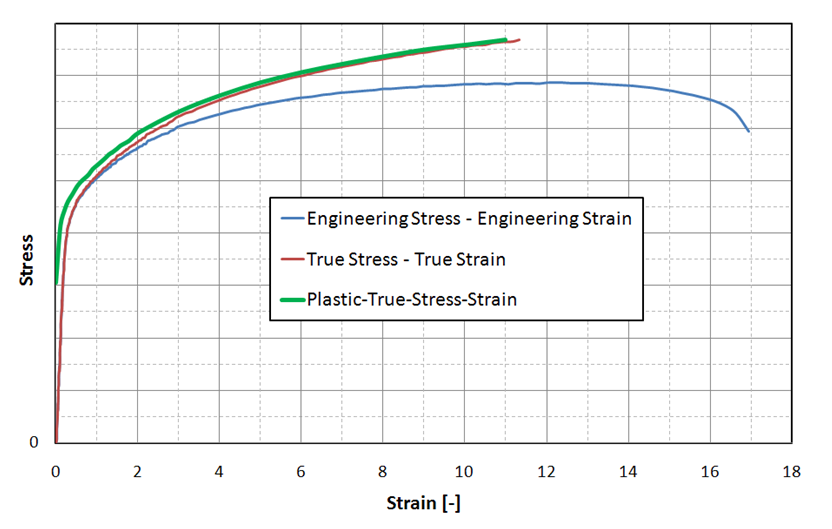

True stress-strain curve which is requested in most materials in Radioss, except in LAW2, where both engineer stress-strain and true stress-strain are possible to input material data.
In Figure 3, find engineer stress-strain curve (blue) by using:
σ t r = σ e exp ( ε t r )
ε t r = ln ( 1 + ε e )
The result is true stress-strain curve (red). Plastic true stress-strain curve is shown in green, which plastic strain begin from 0. This green plastic true stress-strain curve is what you need, as in LAW36, LAW60, LAW63, and so on.
Figure 3.
The true stress-strain curve is valid until the necking point of the material. After the necking point, the material curve has to be defined manually for hardening. Using a different material law, Radioss will extrapolation the true stress-strain curve to 100%.

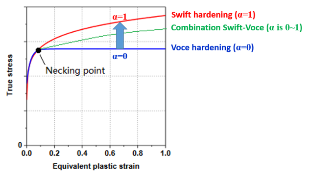

    However, it may overestimate strain hardening for automotive steel, In this case, combination of swift-voce hardening is more accurate.
  • Swift and Voce: After necking point, use one of the following equations to extrapolate the true stress-strain curve.
    Swift model
    σ y = A ( ε ¯ p + ε 0 ) n MathType@MTEF@5@5@+= feaagKart1ev2aqatCvAUfeBSjuyZL2yd9gzLbvyNv2CaerbuLwBLn hiov2DGi1BTfMBaeXatLxBI9gBaerbd9wDYLwzYbItLDharqqtubsr 4rNCHbGeaGqiVu0Je9sqqrpepC0xbbL8F4rqqrFfpeea0xe9Lq=Jc9 vqaqpepm0xbba9pwe9Q8fs0=yqaqpepae9pg0FirpepeKkFr0xfr=x fr=xb9adbaqaaeGaciGaaiaabeqaamaabaabaaGcbaGaeq4Wdm3aaS baaSqaaiaadMhaaeqaaOGaeyypa0JaamyqamaabmaabaGafqyTduMb aebadaWgaaWcbaGaamiCaaqabaGccqGHRaWkcqaH1oqzdaWgaaWcba GaaGimaaqabaaakiaawIcacaGLPaaadaahaaWcbeqaaiaad6gaaaaa aa@43C6@
    A MathType@MTEF@5@5@+= feaagKart1ev2aqatCvAUfeBSjuyZL2yd9gzLbvyNv2CaerbuLwBLn hiov2DGi1BTfMBaeXatLxBI9gBaerbd9wDYLwzYbItLDharqqtubsr 4rNCHbGeaGqiVu0Je9sqqrpepC0xbbL8F4rqqrFfpeea0xe9Lq=Jc9 vqaqpepm0xbba9pwe9Q8fs0=yqaqpepae9pg0FirpepeKkFr0xfr=x fr=xb9adbaqaaeGaciGaaiaabeqaamaabaabaaGcbaGaamyqaaaa@36BD@ and n MathType@MTEF@5@5@+= feaagKart1ev2aqatCvAUfeBSjuyZL2yd9gzLbvyNv2CaerbuLwBLn hiov2DGi1BTfMBaeXatLxBI9gBaerbd9wDYLwzYbItLDharqqtubsr 4rNCHbGeaGqiVu0Je9sqqrpepC0xbbL8F4rqqrFfpeea0xe9Lq=Jc9 vqaqpepm0xbba9pwe9Q8fs0=yqaqpepae9pg0FirpepeKkFr0xfr=x fr=xb9adbaqaaeGaciGaaiaabeqaamaabaabaaGcbaGaamyqaaaa@36BD@ are positive.
    Voce model
    σ y = k 0 + Q [ 1 − exp ( − B ε ¯ p ) ] MathType@MTEF@5@5@+= feaagKart1ev2aqatCvAUfeBSjuyZL2yd9gzLbvyNv2CaerbuLwBLn hiov2DGi1BTfMBaeXatLxBI9gBaerbd9wDYLwzYbItLDharqqtubsr 4rNCHbGeaGqiVu0Je9sqqrpepC0xbbL8F4rqqrFfpeea0xe9Lq=Jc9 vqaqpepm0xbba9pwe9Q8fs0=yqaqpepae9pg0FirpepeKkFr0xfr=x fr=xb9adbaqaaeGaciGaaiaabeqaamaabaabaaGcbaGaeq4Wdm3aaS baaSqaaiaadMhaaeqaaOGaeyypa0Jaam4AamaaBaaaleaacaaIWaaa beaakiabgUcaRiaadgfadaWadaqaaiaaigdacqGHsislciGGLbGaai iEaiaacchadaqadaqaaiabgkHiTiaadkeacuaH1oqzgaqeamaaBaaa leaacaWGWbaabeaaaOGaayjkaiaawMcaaaGaay5waiaaw2faaaaa@4A28@
    k 0 MathType@MTEF@5@5@+= feaagKart1ev2aqatCvAUfeBSjuyZL2yd9gzLbvyNv2CaerbuLwBLn hiov2DGi1BTfMBaeXatLxBI9gBaerbd9wDYLwzYbItLDharqqtubsr 4rNCHbGeaGqiVu0Je9sqqrpepC0xbbL8F4rqqrFfpeea0xe9Lq=Jc9 vqaqpepm0xbba9pwe9Q8fs0=yqaqpepae9pg0FirpepeKkFr0xfr=x fr=xb9adbaqaaeGaciGaaiaabeqaamaabaabaaGcbaGaam4AamaaBa aaleaacaaIWaaabeaaaaa@37CD@ , Q MathType@MTEF@5@5@+= feaagKart1ev2aqatCvAUfeBSjuyZL2yd9gzLbvyNv2CaerbuLwBLn hiov2DGi1BTfMBaeXatLxBI9gBaerbd9wDYLwzYbItLDharqqtubsr 4rNCHbGeaGqiVu0Je9sqqrpepC0xbbL8F4rqqrFfpeea0xe9Lq=Jc9 vqaqpepm0xbba9pwe9Q8fs0=yqaqpepae9pg0FirpepeKkFr0xfr=x fr=xb9adbaqaaeGaciGaaiaabeqaamaabaabaaGcbaGaamyqaaaa@36BD@ and B MathType@MTEF@5@5@+= feaagKart1ev2aqatCvAUfeBSjuyZL2yd9gzLbvyNv2CaerbuLwBLn hiov2DGi1BTfMBaeXatLxBI9gBaerbd9wDYLwzYbItLDharqqtubsr 4rNCHbGeaGqiVu0Je9sqqrpepC0xbbL8F4rqqrFfpeea0xe9Lq=Jc9 vqaqpepm0xbba9pwe9Q8fs0=yqaqpepae9pg0FirpepeKkFr0xfr=x fr=xb9adbaqaaeGaciGaaiaabeqaamaabaabaaGcbaGaamyqaaaa@36BD@ are positive.
    Combination of Swift and Voce model (LAW84 and LAW87)
    σ y = α [ A ( ε ¯ p + ε 0 ) n ] ︸ S w i f t h a r d e n i n g + ( 1 − α ) { k 0 + Q [ 1 − exp ( − B ε ¯ p ) ] } ︸ V o c e h a r d e n i n g MathType@MTEF@5@5@+= feaagKart1ev2aqatCvAUfeBSjuyZL2yd9gzLbvyNv2CaerbuLwBLn hiov2DGi1BTfMBaeXatLxBI9gBaerbd9wDYLwzYbItLDharqqtubsr 4rNCHbGeaGqiVeea0le9v8qqaqFD0xXdHaVhbbf9v8qqaqFr0xc9pk 0xbba9q8WqFfea0=yr0RYxir=Jbba9q8aq0=yq=He9q8qqQ8frFve9 Fve9Ff0dmeaabaqaciGacaGaaeqabaWaaeaaeaaakeaacqaHdpWCda WgaaWcbaGaamyEaaqabaGccqGH9aqpcqaHXoqydaagaaqaamaadmaa baGaamyqamaabmaabaGafqyTduMbaebadaWgaaWcbaGaamiCaaqaba GccqGHRaWkcqaH1oqzdaWgaaWcbaGaaGimaaqabaaakiaawIcacaGL PaaadaahaaWcbeqaaiaad6gaaaaakiaawUfacaGLDbaaaSqaaiaado facaWG3bGaamyAaiaadAgacaWG0bqbaeqabeqaaaqaaaaacaWGObGa amyyaiaadkhacaWGKbGaamyzaiaad6gacaWGPbGaamOBaiaadEgaaO Gaayjo+dGaey4kaSIaaiikaiaaigdacqGHsislcqaHXoqycaGGPaWa aGbaaeaadaGadaqaaiaadUgadaWgaaWcbaGaaGimaaqabaGccqGHRa WkcaWGrbWaamWaaeaacaaIXaGaeyOeI0IaciyzaiaacIhacaGGWbWa aeWaaeaacqGHsislcaWGcbGafqyTduMbaebadaWgaaWcbaGaamiCaa qabaaakiaawIcacaGLPaaaaiaawUfacaGLDbaaaiaawUhacaGL9baa aSqaaiaadAfacaWGVbGaam4yaiaadwgafaqabeqabaaabaaaaiaadI gacaWGHbGaamOCaiaadsgacaWGLbGaamOBaiaadMgacaWGUbGaam4z aaGccaGL44paaaa@7D8E@
Figure 4.
Here, α MathType@MTEF@5@5@+= feaahqart1ev3aaatCvAUfeBSjuyZL2yd9gzLbvyNv2CaerbuLwBLn hiov2DGi1BTfMBaeXatLxBI9gBaerbd9wDYLwzYbItLDharqqtubsr 4rNCHbGeaGqiVu0Je9sqqrpepC0xbbL8F4rqqrFfpeea0xe9Lq=Jc9 vqaqpepm0xbba9pwe9Q8fs0=yqaqpepae9pg0FirpepeKkFr0xfr=x fr=xb9adbaqaaeGaciGaaiaabeqaamaabaabaaGcbaGaeqySdegaaa@3792@ is weight of Swift hardening and Voce hardening. Here, is one Compose script as an example to fit the Swift hardening parameters A MathType@MTEF@5@5@+= feaagKart1ev2aqatCvAUfeBSjuyZL2yd9gzLbvyNv2CaerbuLwBLn hiov2DGi1BTfMBaeXatLxBI9gBaerbd9wDYLwzYbItLDharqqtubsr 4rNCHbGeaGqiVu0Je9sqqrpepC0xbbL8F4rqqrFfpeea0xe9Lq=Jc9 vqaqpepm0xbba9pwe9Q8fs0=yqaqpepae9pg0FirpepeKkFr0xfr=x fr=xb9adbaqaaeGaciGaaiaabeqaamaabaabaaGcbaGaamyqaaaa@36BD@ , ε 0 MathType@MTEF@5@5@+= feaagKart1ev2aqatCvAUfeBSjuyZL2yd9gzLbvyNv2CaerbuLwBLn hiov2DGi1BTfMBaeXatLxBI9gBaerbd9wDYLwzYbItLDharqqtubsr 4rNCHbGeaGqiVu0Je9sqqrpepC0xbbL8F4rqqrFfpeea0xe9Lq=Jc9 vqaqpepm0xbba9pwe9Q8fs0=yqaqpepae9pg0FirpepeKkFr0xfr=x fr=xb9adbaqaaeGaciGaaiaabeqaamaabaabaaGcbaGaeqyTdu2aaS baaSqaaiaaicdaaeqaaaaa@3884@ , n MathType@MTEF@5@5@+= feaagKart1ev2aqatCvAUfeBSjuyZL2yd9gzLbvyNv2CaerbuLwBLn hiov2DGi1BTfMBaeXatLxBI9gBaerbd9wDYLwzYbItLDharqqtubsr 4rNCHbGeaGqiVu0Je9sqqrpepC0xbbL8F4rqqrFfpeea0xe9Lq=Jc9 vqaqpepm0xbba9pwe9Q8fs0=yqaqpepae9pg0FirpepeKkFr0xfr=x fr=xb9adbaqaaeGaciGaaiaabeqaamaabaabaaGcbaGaamyqaaaa@36BD@ and Voce hardening parameters k 0 MathType@MTEF@5@5@+= feaagKart1ev2aqatCvAUfeBSjuyZL2yd9gzLbvyNv2CaerbuLwBLn hiov2DGi1BTfMBaeXatLxBI9gBaerbd9wDYLwzYbItLDharqqtubsr 4rNCHbGeaGqiVu0Je9sqqrpepC0xbbL8F4rqqrFfpeea0xe9Lq=Jc9 vqaqpepm0xbba9pwe9Q8fs0=yqaqpepae9pg0FirpepeKkFr0xfr=x fr=xb9adbaqaaeGaciGaaiaabeqaamaabaabaaGcbaGaam4AamaaBa aaleaacaaIWaaabeaaaaa@37CD@ , Q MathType@MTEF@5@5@+= feaagKart1ev2aqatCvAUfeBSjuyZL2yd9gzLbvyNv2CaerbuLwBLn hiov2DGi1BTfMBaeXatLxBI9gBaerbd9wDYLwzYbItLDharqqtubsr 4rNCHbGeaGqiVu0Je9sqqrpepC0xbbL8F4rqqrFfpeea0xe9Lq=Jc9 vqaqpepm0xbba9pwe9Q8fs0=yqaqpepae9pg0FirpepeKkFr0xfr=x fr=xb9adbaqaaeGaciGaaiaabeqaamaabaabaaGcbaGaamyqaaaa@36BD@ , B MathType@MTEF@5@5@+= feaagKart1ev2aqatCvAUfeBSjuyZL2yd9gzLbvyNv2CaerbuLwBLn hiov2DGi1BTfMBaeXatLxBI9gBaerbd9wDYLwzYbItLDharqqtubsr 4rNCHbGeaGqiVu0Je9sqqrpepC0xbbL8F4rqqrFfpeea0xe9Lq=Jc9 vqaqpepm0xbba9pwe9Q8fs0=yqaqpepae9pg0FirpepeKkFr0xfr=x fr=xb9adbaqaaeGaciGaaiaabeqaamaabaabaaGcbaGaamyqaaaa@36BD@ with input stress-strain curve.
