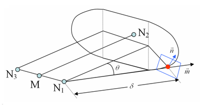

  6. If jetting is used, an additional Δ P j e t pressure is applied to each element of the airbag:
    Δ P jet = Δ P ( t ) Δ P ( θ ) Δ P ( δ ) max ( n · m , 0 )
    With m being the normalized vector between the projection of the center of the element upon segment (N1 and N3) and the center of the element; θ the angle between vectors MN2 and m (in degrees), δ the distance between the center of the element and its projection upon segment (N1 and N3).
    The projection of a point upon segment (N1 and N3) is defined as the projection of the point in direction MN2 upon the line (N1 and N3) if it lies inside the segment (N1 and N3). If this is not the case, the projection of the point upon segment (N1 and N3) is defined as the closest node N1 or N3.
    Figure 1. Dihedral Shape of the Jet
    clip0087
    with M between N1 and N3
  7. If node_ID3 = 0, node_ID is set to node_ID1 and the dihedral shape is reduced to a conical shape.
