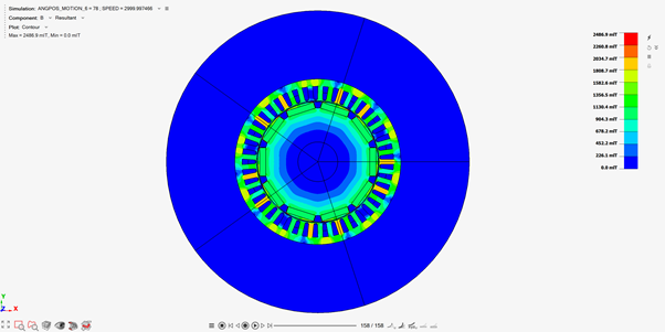

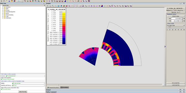

Contour / Arrows / Isoline
At the end of the solving, the contour results are displayed automatically. The contour or arrows and isoline options are visible on the graphical window top-left part.
Note that the full model (symmetry or periodicity) can be displayed by right click and selecting Show Full Model.

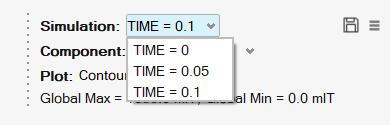

- The Simulation allows selecting the current step
(time or angular position or linear position)

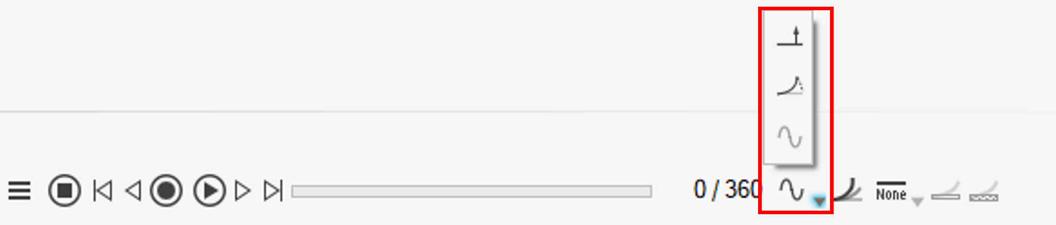

To see the bodies animation, please use the animation tool bar:
Note:The tool bar can be used in Transient Animation Mode, Modal Animation Mode and Linear Animation Mode:
- Transient Animation Mode is suitable for Magneto Static solution, Magnetic Transient solution and Magnetic AC solution (complex quantity’s real part is displayed). The animation makes the time/position vary
- Modal Animation Mode can be used in Magnetic AC solution with or without Motion to display the complex vector results depending on the phase. The animation makes the phase vary
- Linear Animation Mode can be used in Magneto Static solution without Motion

contour or arrows:
- to display the color shade, choose Contour
- to display the arrows, choose Vector
- to display the isolines, choose Iso Line

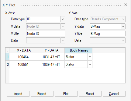

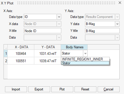

XY Plot
The XY Plot allows the user to do point computations.

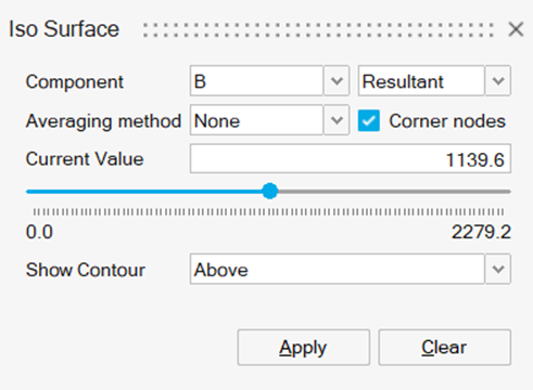

Iso Surface
The Iso Surface menu allows you to display for example the locations where B is greater or lower than a certain value, it allows to display the hot or cold spots.

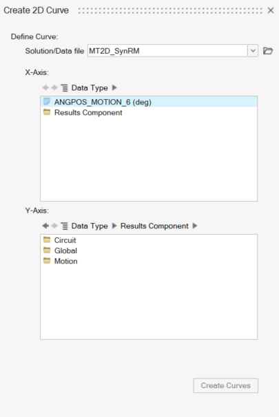

Plot
The Plot allows to post process global quantities chosen in the Result Request dialog box by the user.
- Circuit (current, voltage, ... of electrical components)
- Global (energy over the entire domain, ...)
- Motion (torque, force, ...)

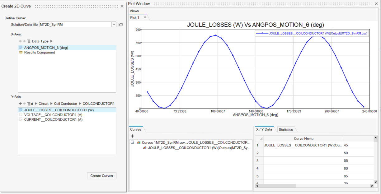

In the Circuit category:
The Joule losses of a coil conductor vs the angular position:

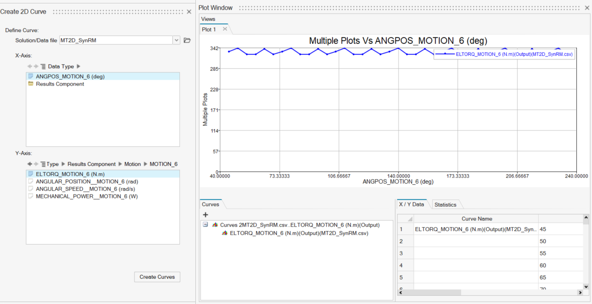

In the Motion category:
The electrical torque vs the angular position:

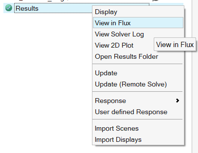

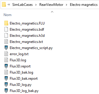

Postprocess in Flux
To access to Flux Postprocessing, in the Model Browser in the Assembly Tab, right click in Results and choose View in Flux.
Additionally to the project *.FLU other files are stored to be able to reproduce the full operations done (*.bdf, *.h3d, *.py) and log files to track a potential problem (*.log, *.report).
