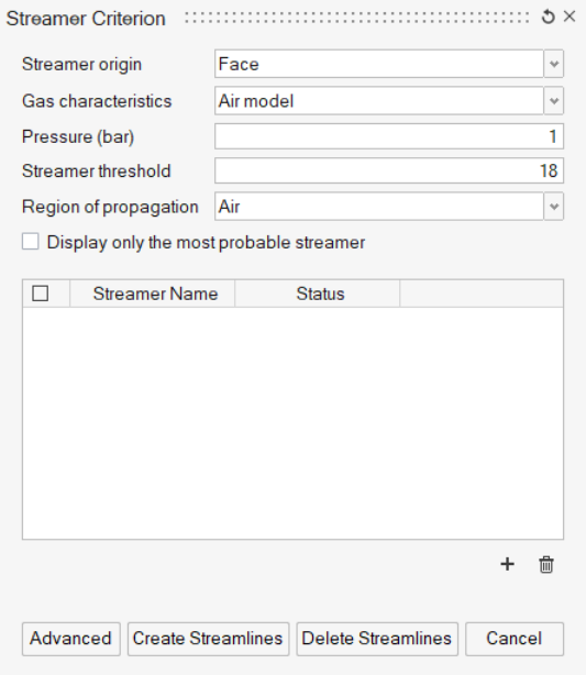

Here is the Streamer Criterion interface:
- Select Streamer origin. For now, only Face is available
- Select the dielectric Gas characteristics between:
- Air model
- SF6 model
- Enter the dielectric gas Pressure value in bar.
- Enter the Streamer threshold value (no units). It correponds to the ionization content K described in Mathematical model and Bisection method. A common value of K is 18.
- Select the Region of propagation corresponding to the dielectric gas by selecting the body.
- Optionnal: Modify Advanced options if necessary
- Select the Streamer starting face(s). Usually it corresponds to the faces of
the high voltage bodies.Note: If user doesn't know if Streamers start from high voltage or low voltage bodies, it is possible to set in the Advanced options the Integration mode option to Integration starting from both sides of path (the computation will take more time in this case).
- Click on the
to create the Streamer computation entity.

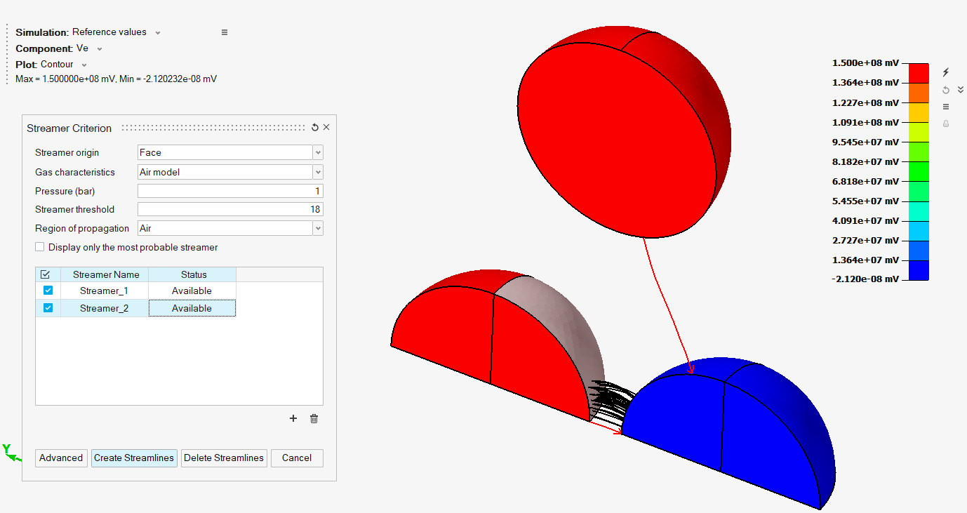

- Launch the Streamer computation by clicking on Create
Streamlines
The Streamer computation entities contain now results and the Status becomes Available.
The Streamer results are now visible. The most critical path (having the lowest Streamer inception voltage) is represented by a red arrow. Black paths can be displayed: their Streamer inception voltage are higher than critical path inception voltage and lower than the voltage applied in the simulation. Here is an example of results:
It is possible to check the option Display only the most probable streamer to see only the most critical path

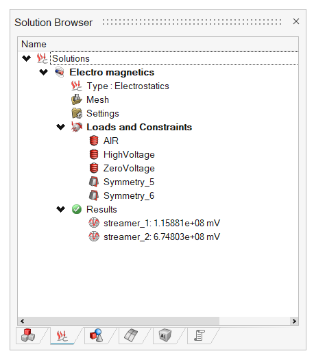

The Streamer inception voltage value associated to the red arrow is available in the Results in the Solution tab of the data tree. Here is an example:
Note: It is possible to delete Streamer computation entity results by clicking on Delete Streamlines. The computation can be launched again.
