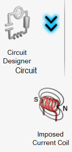

Click on the Imposed Current Coil button in Analysis ribbon:

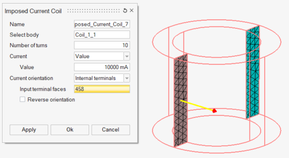

- Internal terminals is selected when the
coil is closed and is fully represented (not cut by symmetry or
periodicity).
Select face(s) in Input terminal faces corresponding to coil body's internal face(s).
→ As soon as this selection is done, only body's internal face(s) are visible and a preview of the current direction is displayed through arrow(s) starting from the Input terminal faces
It is possible to reverse the direction through Reverse orientation checkbox and see the preview updated.

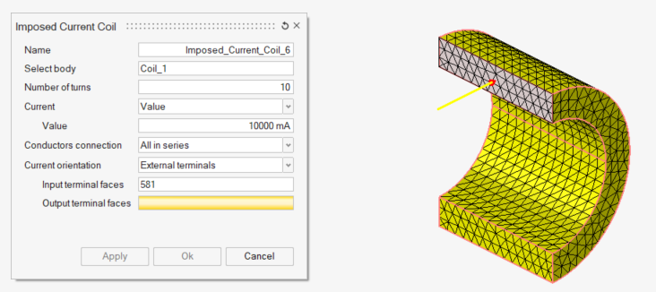

- External terminals is selected when the
coil is not closed (cut by symmetry or periodicity)
- Select the Input terminal
faces
It is the face(s) through which the current enters
→ A preview of the current direction is displayed through arrow(s) on the Input terminal faces

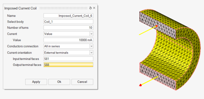

- Select the Output terminal
faces
It is the face(s) through which the current exits
→ A preview of the current direction is displayed through arrow(s) on the Output terminal faces

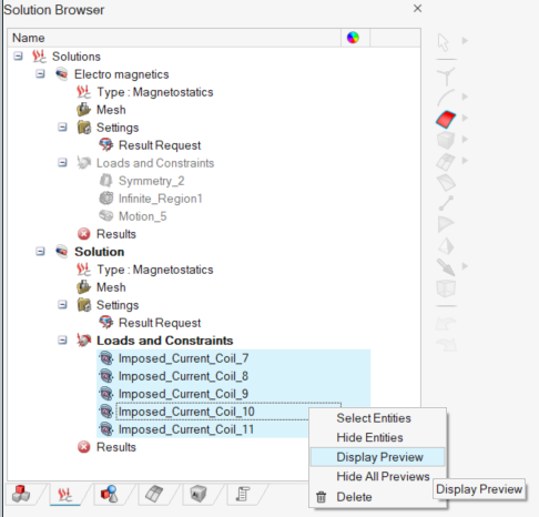

Display Imposed Current Coil preview
Adding to the preview visualisation during Imposed Current Coil creation and edition, the command Display Preview allows to display Imposed Current Coil previews at any time.
For that, right-click on the Imposed Current Coil entities and click on Display Preview command.
→ All the selected Imposed Current Coil entities previews become visible on the
graphic:
The command Hide All Previews in the same contextual menu allows to hide the preview and reset the graphical view.
