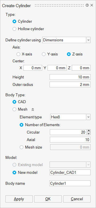

- Type: User can choose between Solid Cylinder and Hollow Cylinder.
- Define Cylinder Options
- Dimensions: User can specify the height and
radius of cylinder. In case of hollow cylinder, both inner and outer
radius have to be specified.
- Axis: User can choose the global axis to define the cylinder.
- Center: User can either pick a node, vertex or arc edge to define the center of the cylinder or enter the coordinates value directly.
- Height: Enter the height of the cylinder.
- Outer radius: Enter the outer radius of the cylinder. Radius will be dynamically updated upon Cylindrical Face or Arc edge selection.
- Inner radius: Enter the inner radius
Cylindrical Face or Arc edge selection.Note: This option will be visible only for hollow cylinder.

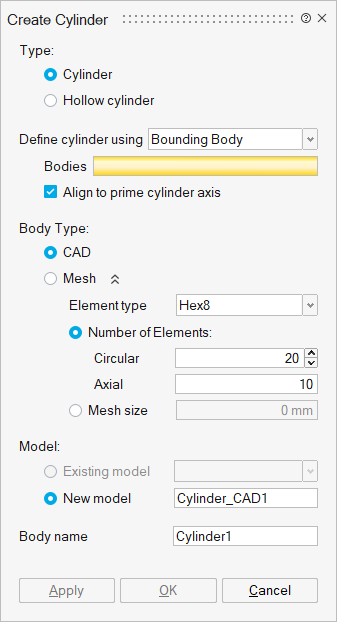

- Bounding Body: Pick a Body to define the
cylinder. The dimensions of the cylinder can be edited.
- Align to prime cylinder axis: The axis of larger (area) cylinder face in the selected bodies will be used as the cylinder axis.
- Selected Faces: Select a set of faces to define a cylinder that encloses the given faces.
- Body Type:
- CAD: To create CAD (Parasolid) cylinder.
- Mesh: To create mesh cylinder.
- Element Type: To create a mesh cylinder, user can specify the element type as Tri3, Tri6, Quad4, Wedge6, Tet4, Tet10 and Hex8.
- No of Elements/Mesh Size: User can specify the number of elements along circular and axial directions or mesh size.
- Model
- Existing Model: If this toggle is ON, the
cylinder will be added to the specified existing model.Note: For CAD (Parasolid), only models that were imported with Save geometry in database option will be listed.
- New Model: If this toggle is ON, the cylinder will be added to the new model.
- Body Name: User can specify the body name.
