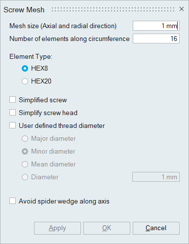

Screw Mesh
Screws can be HEX meshed automatically using this tool. Input can be FEM or CAD bodies.

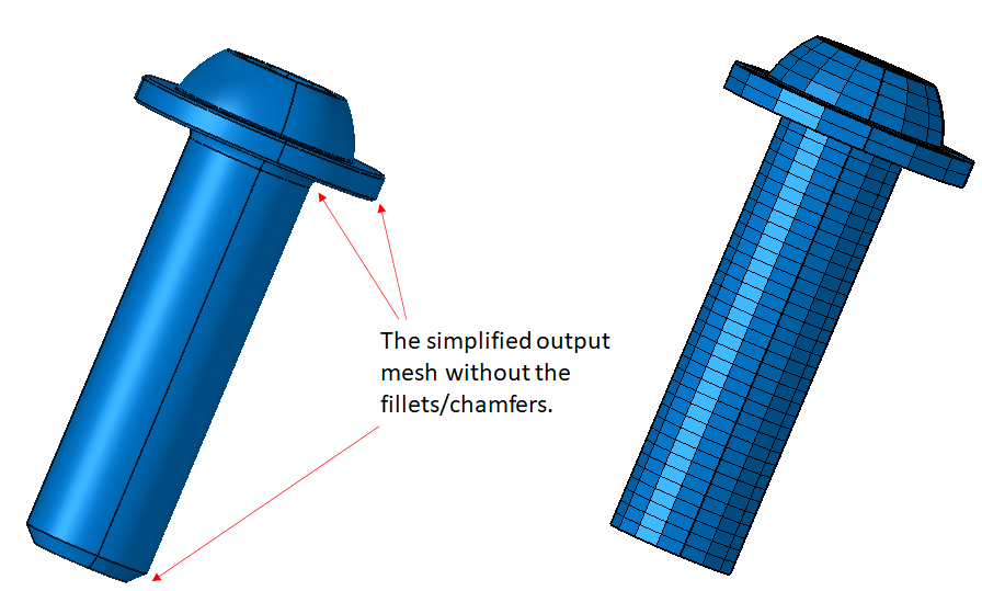

Simplify screw
Turn this toggle ON to get a simplified output mesh for the screw. Slots in the screw head and all the fillets/chamfers get removed.
Example

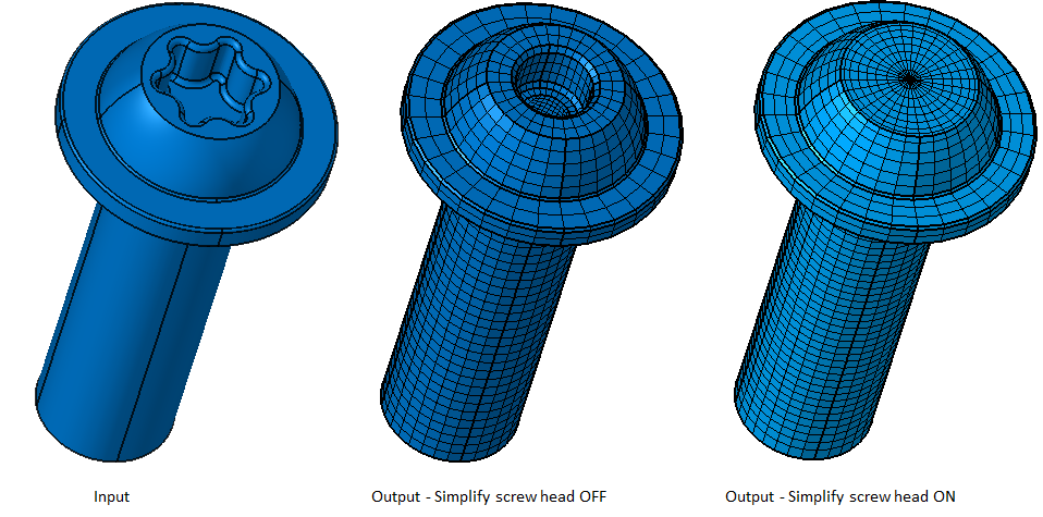

Simplify screw head
Turn this toggle ON to simplify the screw head.
Example

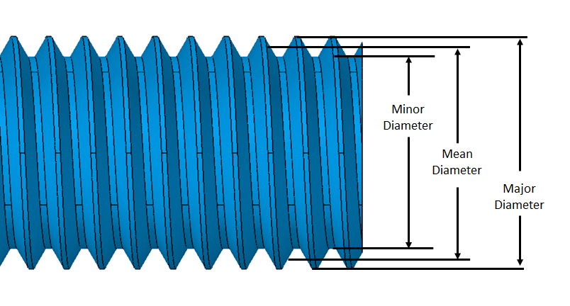

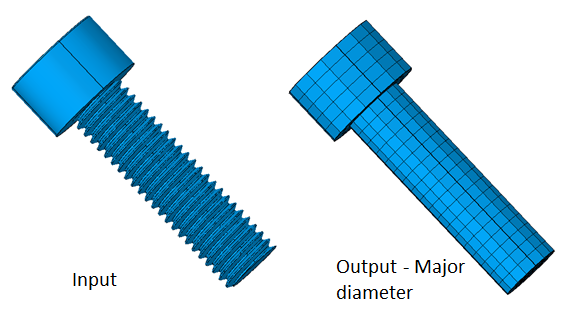

User defined thread diameter
The screw threads are simplified to cylindrical surfaces using the thread root radius. The thread diameter can be customized using this option.
Example: Threaded screw

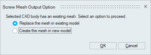

Note:
- For the FE body input, the output mesh gets updated to the input body itself.
- For the CAD input,
- If the CAD model meshed for the first time, output mesh gets created in a new model.
- The subsequent meshing of the CAD model,
- If input CAD bodies do not have equivalent mesh in the existing FE model, the output mesh gets created in this FE model.
- If there exists an equivalent mesh, it posts the
following message. Based on the user's selection,
mesh output will be created in a new model or get
replaced in the existing model.
