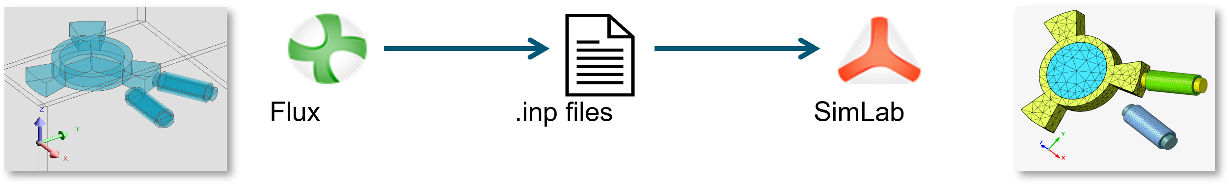

Why an Abaqus Flux Import
Since several releases of Flux, the Flux teams works a lot to integrate the various applications in SimLab. The main goal of this integration are the homogenization of the easy GUI of all Altair's softwares, and the easy to use to be able to do multiphysics modeling (NVH, Thermal, Electromagnetic, Electrostatic...).
To ensure a smooth transition for Flux users to SimLab, we are working on an export of Flux projects in an Abaqus format. The resulting file can then be imported into SimLab.
We're working hard to convert as much of a Flux project as possible to a SimLab database, but there will be some limitations.
A beta version has been delivered with the last release 2025 of Flux (for Abaqus export) and SimLab (for Abaqus Import) with several limitations. The work continued on this release 2025.1, and several limitations has been managed.
| Flux | ![]() |
| SimLab | ![]() |
- Exporting a Flux project produces a “Ready to solve” project in SimLab. As a result, the simulation results obtained in Flux are not migrated into SimLab, and you will have to re-solve the project from SimLab.

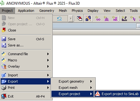

- Open the Flux project which you want export
- In the menu Project select
- Choose the Output directory
- Click on OK
→ The main files flux_simlab_init.inp is created with a folder called includes containing all needed secondary files

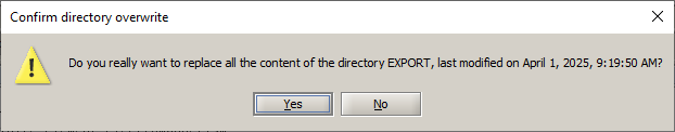

Note: If the chosen directory is not empty, a message appear to propose to erase or the content of the directory (YES) or to choose another directory (NO → go to step 1, and choose another directory at the step 3))

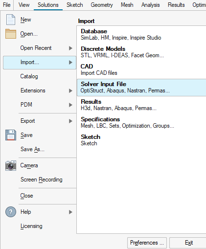

- Open SimLab
- Import the master abaqus file *.inp:
- Open the Import dialog box by selecting
- Choose the extension of the import as Flux
(*.inp) in the bottom right corner:→ the folder is filtered and only the flux_simlab_init.inp is displayed

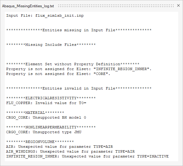

→ Some Warnings could be displayed

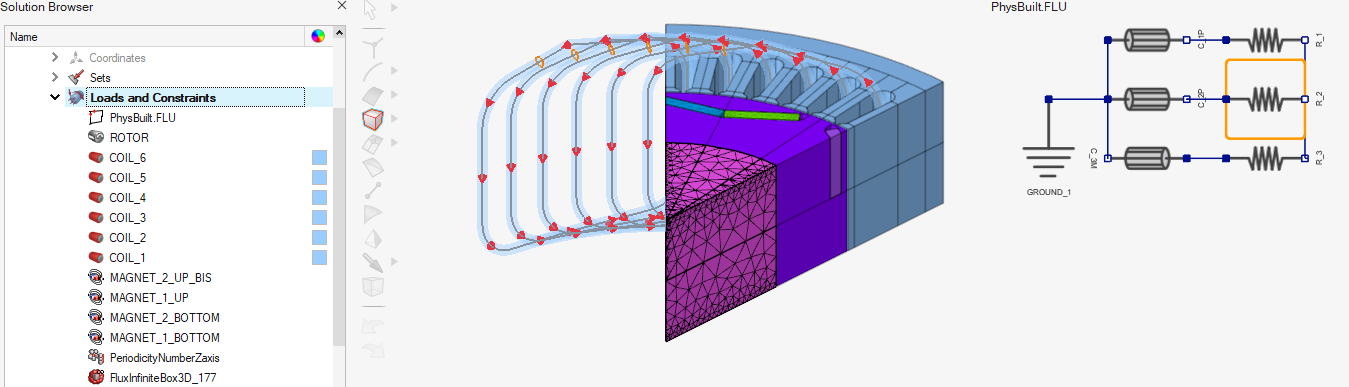

→ The Flux project is imported in SimLab and the database SimLab is created with all corresponding Bodies, LBC,...→ A log is opened with the list of missing entities and other informations
Step 6c 6d

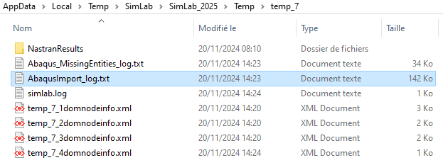

→ The log file "AbaqusImport_log.txt" is stored in the user scratch directory define in Preference of SimLab. By defaut it's:
C:\Users\"NameOfUser"\AppData\Local\Temp\SimLab\SimLab_2025\Temp\temp_x

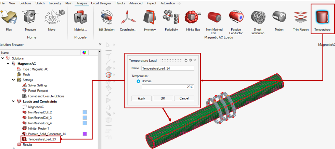

| Temperature |
LBC to define Default working temperature (Linked with Material with Thermal option). |

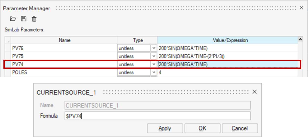

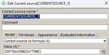

Flux project: required modifications
For compatibility reason with SimLab, when you execute the command "Export project to SimLab in Flux, some needed modifications are applied in background before to export to be able to convert to a corresponding SimLab Database:

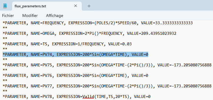

- When a field is defined by a formula (which could be defined also by other
parameters), a new parameter is created with the same formula and exported.
The initial field is modified and filled this new intermediate
parameter.
All these intermediate parameters are listed in a txt file: ..\includes\parameters\flux_parameters.txt

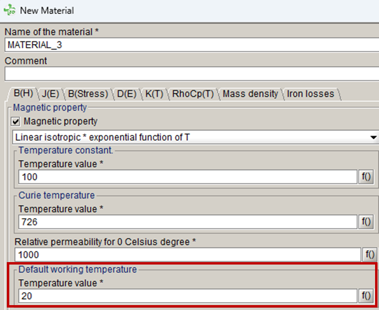

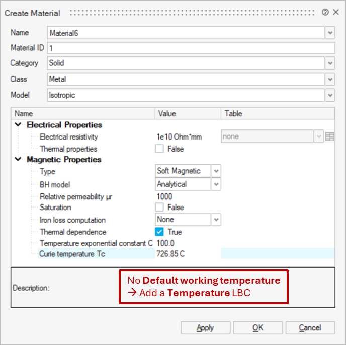

Default Working Temperature
- In Flux: the default working temperature is defined in the material model
- In SimLab the default working temperature is not defined in the material but via the creation of an LBC called Temperature assigned to expected body/bodies. The material must be assigned to the same body /bodies to validated the thermal model.
| In Flux | In SimLab |
