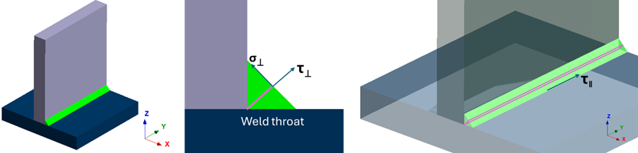

    The below equations are as per the bending theory:
    Normal stress due to normal force ( F z ) along the vertical direction of the weld:
    σ ⊥ = F z A T
    Normal stress due to bending moment ( M x ) along the vertical direction of the weld:
    σ ⊥ = M x r y I w x
    Shear stress due to shear force ( F x ) along the vertical direction of the weld:
    τ ⊥ = F x A T
    Shear stress due to shear force ( F y ) along the parallel direction of the weld:
    τ ∥ = M z r y J T
    Shear stress due to moment ( M z ) along the vertical direction of the weld:
    τ ⊥ = M z r y J T
    Shear stress due to moment ( M z ) along the parallel direction of the weld:
    τ ∥ = M z r x J T
    Equations used to calculate the maximum stress for each component:
    Maximum normal stress along the vertical direction of the weld,
    σ ⊥ m a x = F z A T + M z r y I w x
    Maximum shear stress along the vertical direction of the weld,
    τ ⊥ m a x = F x A T + M z r y J T
    Maximum shear stress along the parallel direction of the weld,
    τ ∥ m a x = F y A T + M z r x J T
    Where,
    σ ⊥
    Normal stress vertical to the weld direction
    τ ⊥
    Shear stress vertical to the weld direction
    τ ∥
    Shear stress parallel to the weld direction

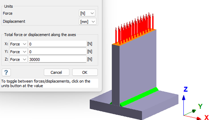

Case study 1
To calculate the stress components for a weld along its throat which connects a beam using double-sided fillet weld. Vertical force of 30 KN is applied along +Z-axis and constrained at the base plate.

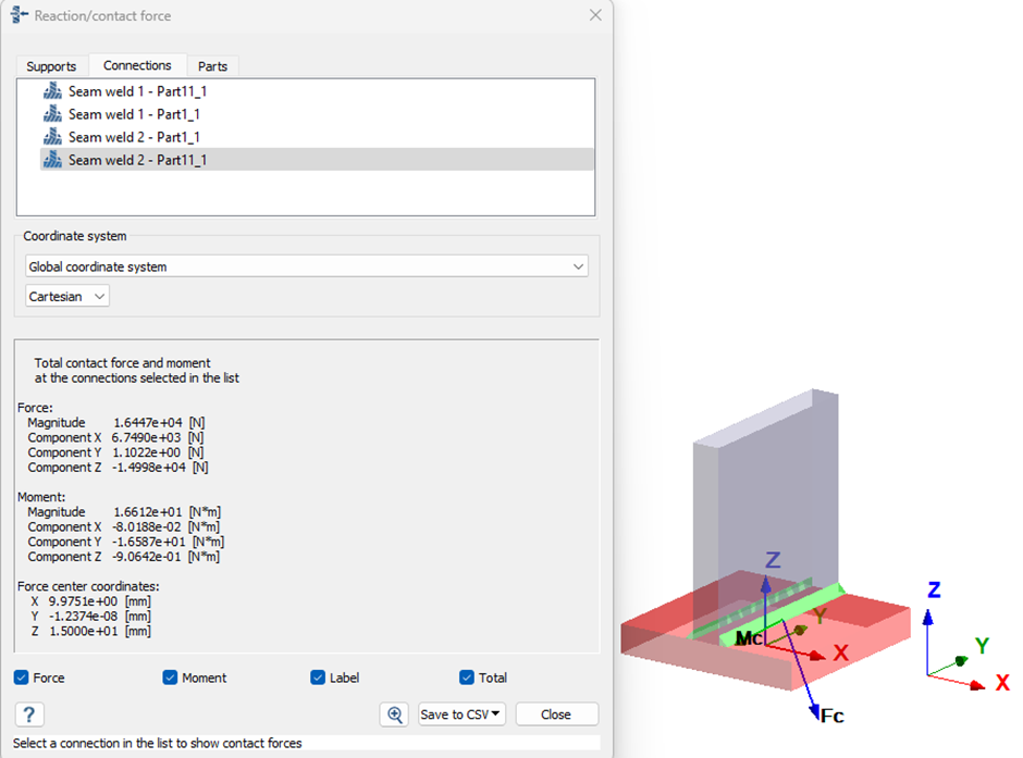

Force and moment components for one of the welds is taken from the Reaction/contact force dialogue as shown below.
Figure 3.
Table 1.
FX = 6.75E+03 N
FY = 1.10E+00 N
FZ = -1.50E+04 N
MX = -80.1880 Nmm
MY = -16587.0000 Nmm
MZ = -906.4200 Nmm

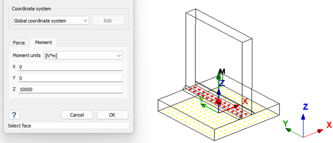

Case study 2
To calculate the stress components for a weld along its throat which connects a beam using double-sided fillet weld. Moment of 1e7 N-mm is applied along z-axis on the base surface of the vertical plate as shown below and constrained at the base plate.

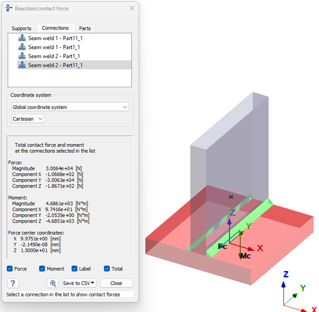

Figure 5.
Table 4.
FX = -106.6800 N
FY = -30063.0000 N
FZ = -186.7100 N
MX = 97416.0000 Nmm
MY = -2053.5000 Nmm
MZ = -4685100.0000 Nmm
