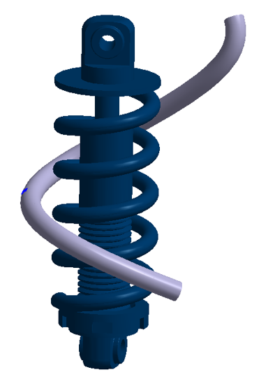

Figure 1. Shock absorber with hose

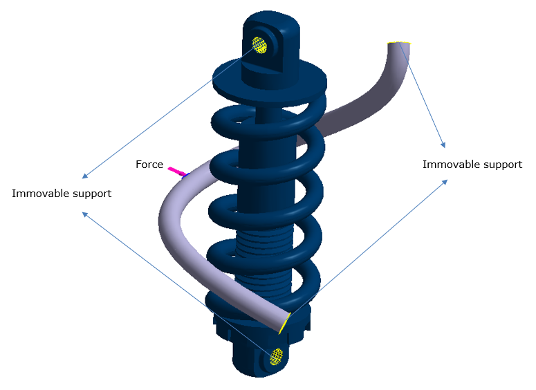

Review Loads and Boundary Conditions
In the Project Tree, expand the Multi-loadcases 1 analysis branch and verify the loads and boundary conditions are as shown in the figure below.
Figure 2. Loads and boundary conditions

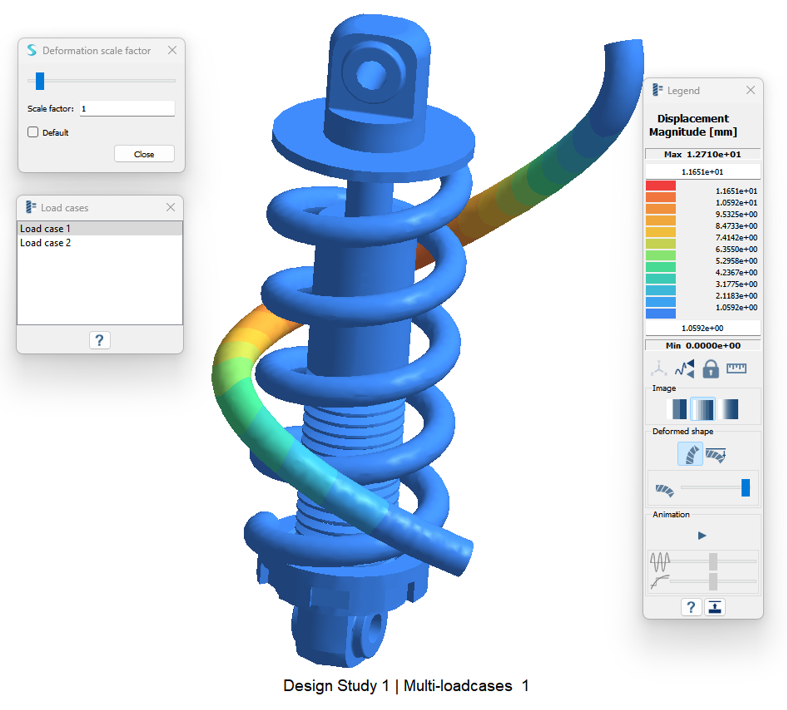

Review Structural Results
  1. In the Project Tree, select the Multi-loadcases 1 subcase.
  2. On the Analysis Workbench, click Results plot > Displacement Magnitude.
    The Legend window opens and displays the contour plot.
  3. In the Legend window, click Deformed shape.
    1. Click Change max deformation.
    2. In the Deformation scale factor dialog, set the Scale factor to 1 to view the true deformation.
    Figure 3. Load case 1 results
    Notice the hose is coming close to spring but it is not contacting the spring.

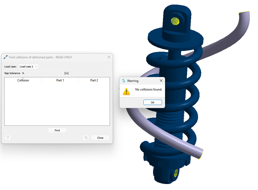

  1. On the Analysis Workbench, click Find collisions on deformed structure.
  2. In the dialog, select Load case ➔ Load case 1.
  3. Ensure Gap tolerance is 0.
  4. Click Find.
    Figure 5. No collisions are found for load case 1
    A no collisions found warning pops-up. In the Review Results step, Load case 1 showed no collisions so this is expected.
  5. Click OK.

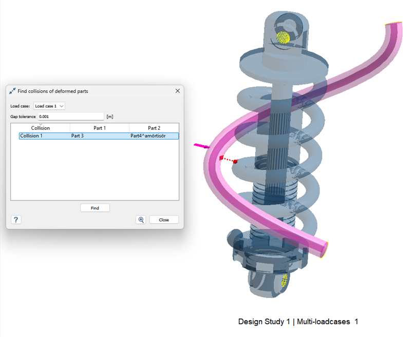

  6. For Gap tolerance, enter 0.001 m.
  7. Click Find.
    Figure 6. Dialog shows part names and area of parts colliding
    The tolerance value is currently sufficient to cover the gap between hose and spring which means collisions are detected between these two parts. The dialog shows part names and the area of the parts colliding.

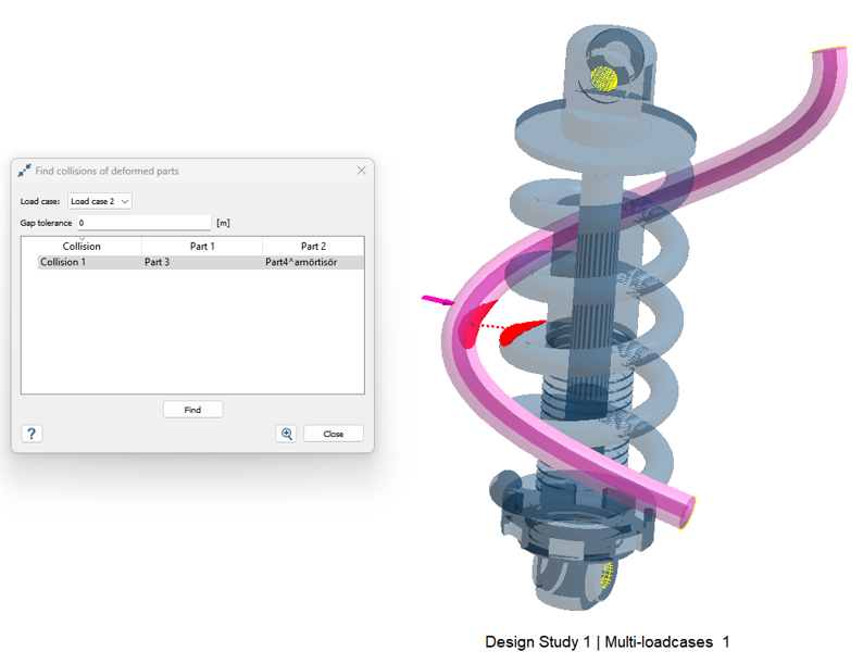

  8. In the dialog, select Load case ➔ Load case 2.
  9. Ensure Gap tolerance is 0.
  10. Click Find.
    Figure 7. Collisions found for load case 2
    For Loadcase 2, all collisions from Review Results were found.
