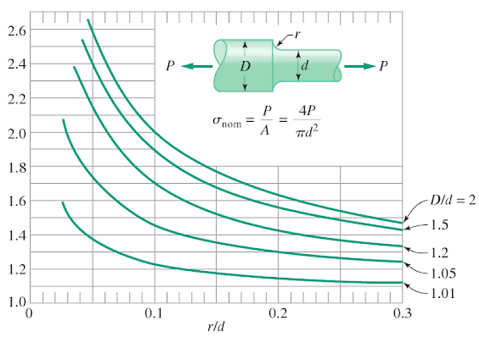

Results
The reference solution is given by:
σ m a x =   k σ n o m MathType@MTEF@5@5@+= feaahqart1ev3aqatCvAUfeBSjuyZL2yd9gzLbvyNv2CaerbuLwBLn hiov2DGi1BTfMBaeXatLxBI9gBaerbd9wDYLwzYbItLDharqqtubsr 4rNCHbGeaGqiVCI8FfYJH8YrFfeuY=Hhbbf9v8qqaqFr0xc9pk0xbb a9q8WqFfeaY=biLkVcLq=JHqpepeea0=as0Fb9pgeaYRXxe9vr0=vr 0=vqpWqaaeaabiGaciaacaqabeaadaqaaqaaaOqaaabaaaaaaaaape Gaeq4Wdm3damaaBaaaleaapeGaamyBaiaadggacaWG4baapaqabaGc peGaeyypa0JaaiiOaiaadUgacqaHdpWCpaWaaSbaaSqaa8qacaWGUb Gaam4Baiaad2gaa8aabeaaaaa@4325@
K t   ≅ 2.6   MathType@MTEF@5@5@+= feaahqart1ev3aqatCvAUfeBSjuyZL2yd9gzLbvyNv2CaerbuLwBLn hiov2DGi1BTfMBaeXatLxBI9gBaerbd9wDYLwzYbItLDharqqtubsr 4rNCHbGeaGqiVCI8FfYJH8YrFfeuY=Hhbbf9v8qqaqFr0xc9pk0xbb a9q8WqFfeaY=biLkVcLq=JHqpepeea0=as0Fb9pgeaYRXxe9vr0=vr 0=vqpWqaaeaabiGaciaacaqabeaadaqaaqaaaOqaaabaaaaaaaaape Gaam4sa8aadaWgaaWcbaWdbiaadshaa8aabeaak8qacaGGGcGaeyyr IaKaaGOmaiaac6cacaaI2aGaaiiOaaaa@3DEF@
The following table summarizes the stress results.
Theory SimSolid % Difference
SZ Stress [MPa] 2.6000E+00 2.5976+00 -0.09%
1 Collins, J. (2010). Mechanical design of machine elements and machines. Hoboken, NJ: Wiley.
