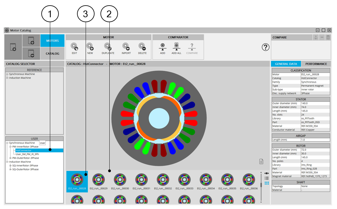

All the motors resulting from the operations performed with HyperStudy can be used back in Motor Catalog of FluxMotor®, and then these can be edited in Motor Factory very quickly.
| Motor Catalog – Visualization of results got from HyperStudy® – Illustration for a synchronous machine | |
| 1 | A catalog is automatically built by using the name of the connector defined by the user |
| 2 | All the operations from HyperStudy® are stored in the dedicated catalog |
| 3 | Each motor can be selected, visualized and edited in the Motor Factory, to be evaluated more in depth |

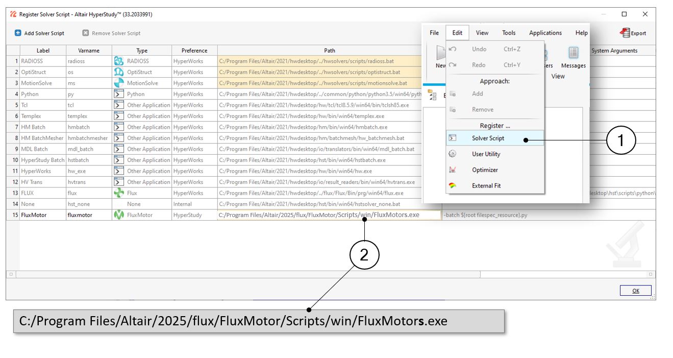

Before starting new studies in HyperStudy® by using connectors exported from FluxMotor®, FluxMotor® must be registered as a new solver script in HyperStudy®.
This must be defined only while using the coupling for the first time.
| Connection between FluxMotor and HyperStudy | |
| 1 | Open the area in HyperStudy® to register FluxMotor® 2025 script |
| 2 | Path where FluxMotor s .exe must be selected to
be registered as a new solver in HyperStudy®. Note: FluxMotor s .exe with a “s”
at the end of FluxMotor s. This must be defined
only while using the coupling for the first time. Note: Since the version 2022.1 of HyperStudy, the
FluxMotor solver script is automatically registered, when the default
path installation is selected while installing Flux and
FluxMotor |

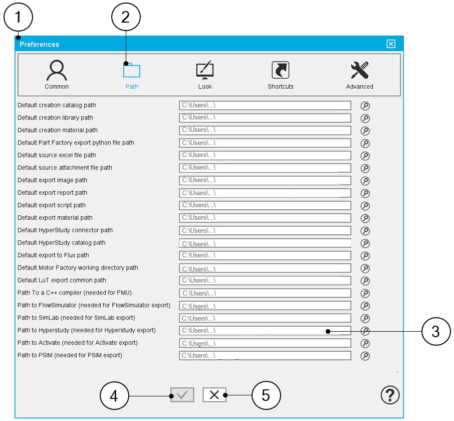

| Path to HyperStudy – Needed for HyperStudy export – It must be defined in the user preferences (Supervisor of FluxMotor) |
