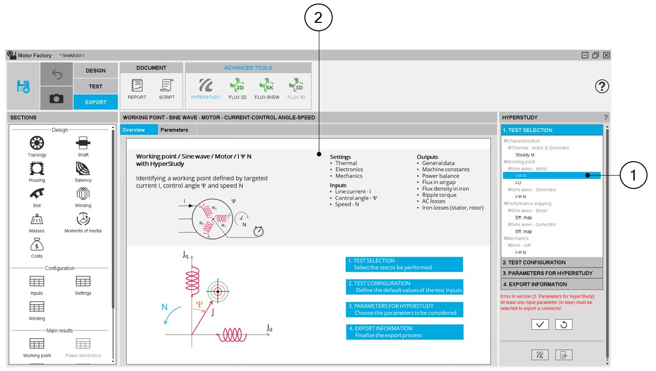

Test selection
In the current version of FluxMotor, 7 tests can be selected for Reluctance Synchronous Machines:
- Characterization / Thermal / Motor & generator / Steady state
- Working point / Sine wave / Motor / I-Ψ-N
- Working point / Sine wave / Motor / I-U
- Working point / Sine wave / Generator / I-Ψ-N
- Performance mapping / Sine wave / Motor / Efficiency mapping
- Performance mapping / Sine wave / Generator / Efficiency mapping
- Mechanics / NVH / Working point / I-Ψ-N
When a test is selected, the corresponding overview is displayed at the center of the screen, showing the main inputs to be considered.
| Motor Factory – EXPORT AREA – Export connector for HyperStudy® | |
| 1 | Selection of a test to be performed by HyperStudy® |
| 2 | Display of general information (overview) dealing with the selected test |

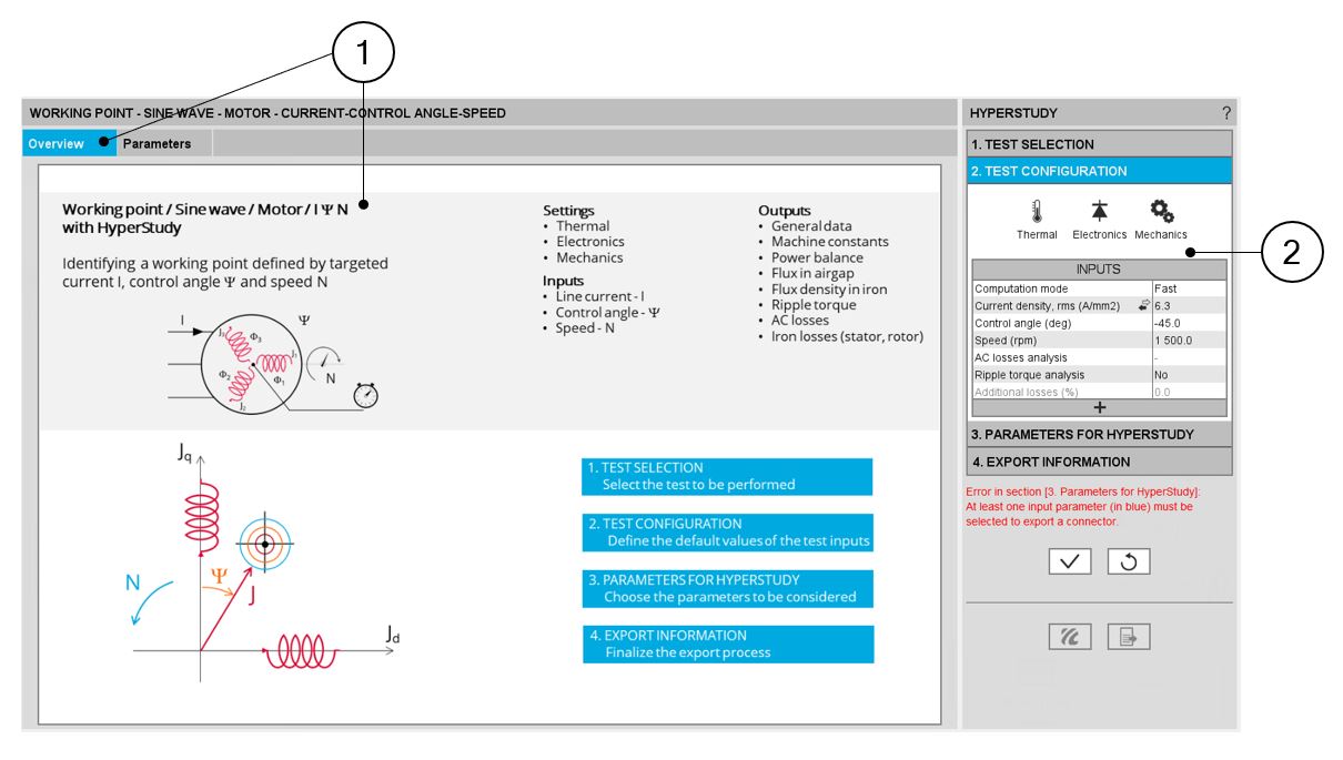

Test configuration
After selecting a test, the corresponding test inputs (settings and user inputs) must be defined. This allows to define the initial conditions for testing.
| 1 | Overview of the selected test is displayed. |
| 2 | User inputs can be defined in the test area. |

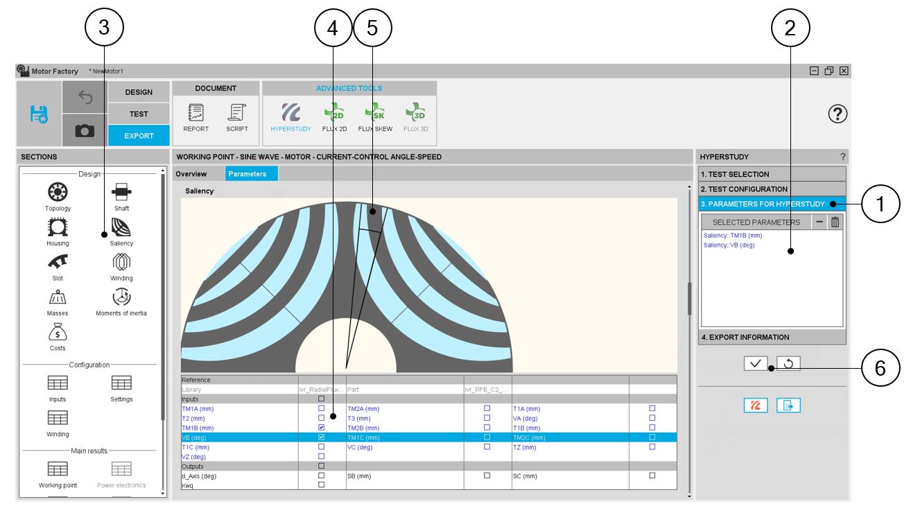

Selection of design parameters
| Motor Factory – EXPORT AREA – Export connector for HyperStudy® Design parameters selection | |
| 1 | Tab to be expanded to choose input/output parameters for HyperStudy® |
| 2 | Area in which input/output parameters are stored for HyperStudy® |
| 3 | Shortcuts to select the part of the design to be considered for the selection of parameters |
| 4 | All available design inputs are displayed. The corresponding dimension is highlighted when selected - arrow (5).When a parameter is chosen, the associated box is ticked (4), and the parameter name is stored in the selected parameters area (2). |
| 5 | Arrow illustrating the selected design input parameter |
| 6 | Button to validate the previous choices |

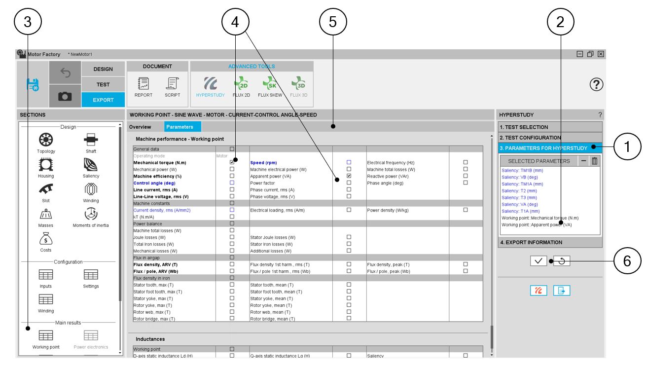

Selection of test data
The test data groups test results as well as the user inputs and settings. All these data can be selected for optimization in HyperStudy®.
| Motor Factory – EXPORT AREA – Export connector for HyperStudy® – Test data selection | |
| 3 | Shortcuts to select the part of the test condition and test results to be considered for the selection of parameters |
| 4 | All available test data (test results as well as user inputs) are
displayed. When a data is chosen, the associated box is ticked (4), and the parameter name is stored in the selected parameters area (2). |
| 5 | Display of data which can be selected for HyperStudy® studies |

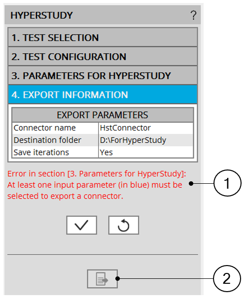

Export information
The last step for building the connector for HyperStudy® is to define the export information.
There are three data to be defined:
- The name of the connector
- The folder in which the connector must be stored
- The last answer, “Save iteration (Yes/No)“ indicates if the results of the HyperStudy® must be stored in a dedicated catalog of Motor Catalog application. When “Yes” is answered all the resulting motors can be visualized in Motor Catalog, and then these can be edited in the Motor Factory very quickly.

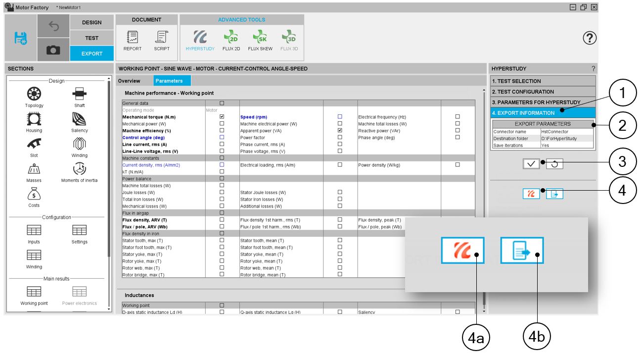

| Motor Factory – EXPORT AREA – Export connector for HyperStudy® – Export information | |
| 1 | Tab to be expanded to define the export information for HyperStudy® |
| 2 | Area in which the export parameters to be defined are listed |
| 3 | Button to validate the previous choices |
| 4 | Button to finalize the export of the connector. |
| 4a | To finalize this operation from FluxMotor, a first button allows to directly and automatically launches HyperStudy, builds and load the connector to perform the optimization |
| 4b | Button to finalize the export of the connector. When one clicks on this button opened the folder where the connector is stored. |
When one clicks on this button (1), HyperStudy is automatically opened, with the connector built by FluxMotor uploaded.
The studies can be initialized and run immediately in HyperStudy. The input variables as well as the Output responses that have been selected in FluxMotor are automatically identified and uploaded.
| Motor Factory – EXPORT AREA – Export connector for HyperStudy® – Error message | |
| 1 | Error message written in red font |
| 2 | The button to export the connector is not active if the needed data is missing |

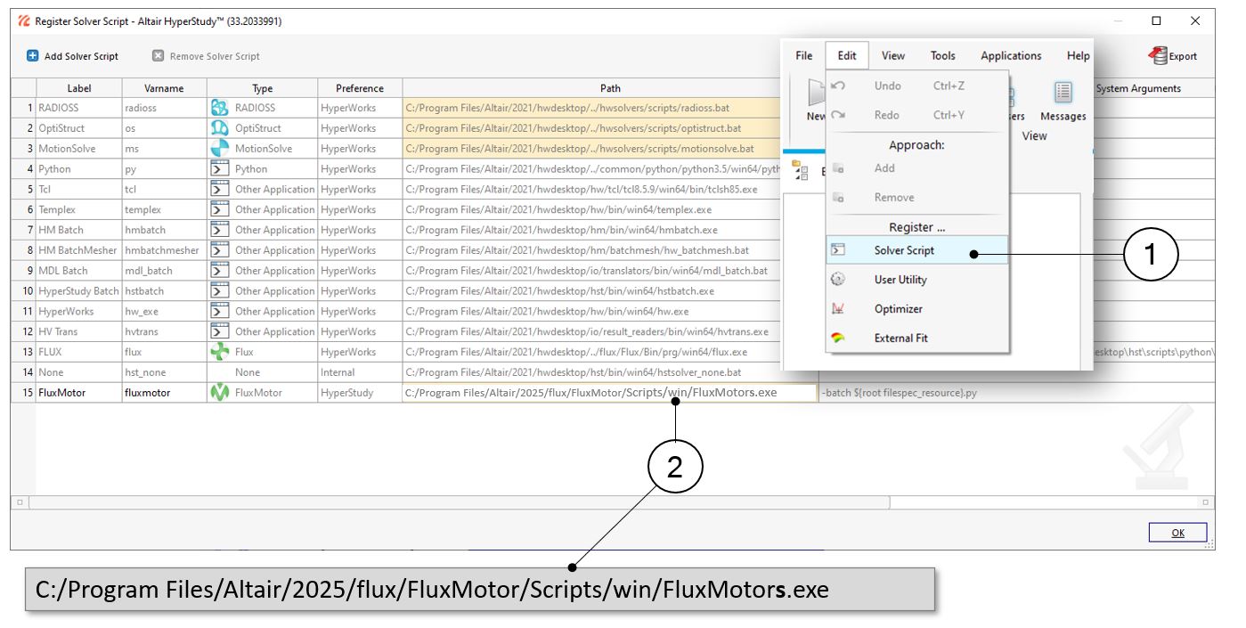

Connection between FluxMotor and HyperStudy®
Before starting new studies in HyperStudy® by using connectors exported from FluxMotor® , FluxMotor® must be registered as a new solver script in HyperStudy®.
This must be defined only while using the coupling for the first time.
| Connection between FluxMotor® and HyperStudy® | |
| 1 | Open the area in HyperStudy to register FluxMotor 2025 script |
| 2 | Path where FluxMotor s .exe must be selected to
be registered as a new solver in HyperStudy. Note: :
FluxMotor s .exe with a “s” at the end of
FluxMotor s. This must be defined only while using
the coupling for the first time. Note:
Since the version 2022.1 of HyperStudy, the FluxMotor solver script is
automatically registered, when the default path installation is selected
while installing Flux and FluxMotor. |

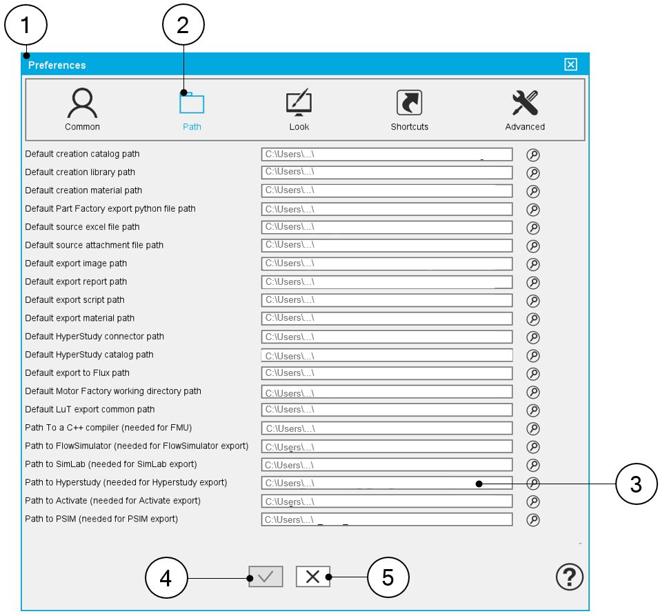

| Path to HyperStudy – Needed for HyperStudy export. It must be defined in the user preferences (Supervisor of FluxMotor) |
