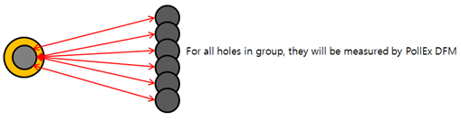

- Check Clearance with Individual Holes in Group: For grouped
holes, if this option is enabled, PollEx DFM checks all clearances between
the target hole and all individual holes in the group.
- Allows overlapped holes with matching locations: Allow if the coordinates of two different holes match.

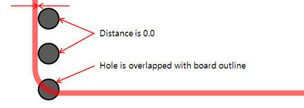

- Clearance to Board Outline: To check the clearance to the board
outlines edge, set the clearance value.
- Except for Overlapped Hole (Distance 0.0): If this option is
on, PollEx DFM skips checking for
holes overlapped with board outline.

- Clearance to Other Holes: To check the clearance to the other holes,
