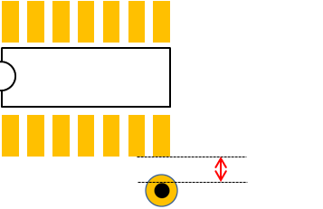

- Clearance between Hole and Component Pads: Set the clearance
value between target vias’ holes and components.
- Check Via Hole Existence within Component Area: Check whether vias
hole are in component boundary.
- Target Component Group: Select target components from component group list.

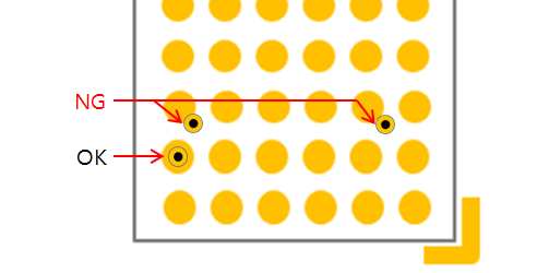

- Via Location on Pad’s Center: If via placed on pad’s area, they
should be placed at same location. Item checks whether they are at
same location or not. If their locations are different, it is
fail.
- Item: Specify the item name.
- Comp Group: Select target components from component group list.
- Via Type: Select via type.
- Tolerance: Set tolerance value. Within tolerance, PollEx DFM treats them as same location.
