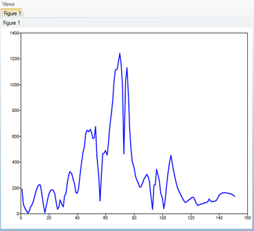

x=[1:151];
y=readvector('<installation_directory>/tutorials/ANGACC','Angular
Acceleration','50th% Hybrid3 - LOWER TORSO','Res. ang. acc.');
plot(x,y);

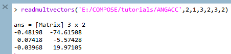

In this case, the first time step is selected and multiple requests and components are selected

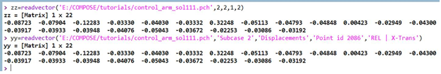

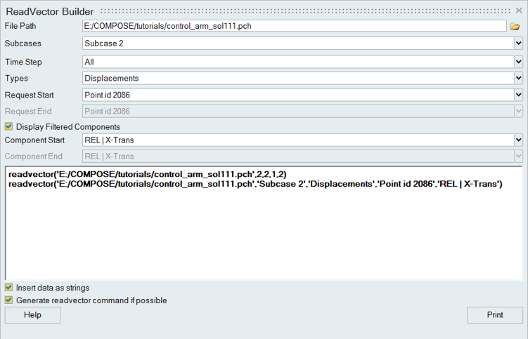

In this example, subcases are available in the data file. Subcase 2 is selected. For Time Step, All is selected. One node, for example, 'Point id 2086', is picked, and the 'REL | X-Trans' -displacement is queried. The Generate readvector command if possible check box is selected.
In Compose, these commands extract the displacement along 'REL | X-Trans' of node 'Point id 2086' in the second subcase of this result file:

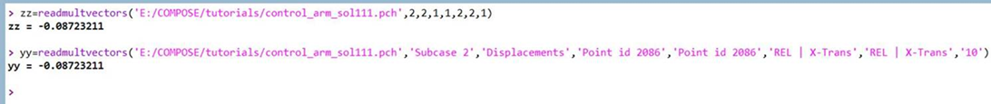

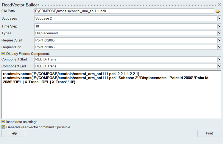

In this example, subcases are available in the data file. Subcase 2 is selected, as is Single time Steps. One node, for example, 'Point id 2086', is picked and the 'REL | X-Trans' -displacement is queried. The Generate readvector command if possible check box is selected.
In Compose, these commands extract the displacement along 'REL | X-Trans' of node 'Point id 2086' in the second subcase of this result file for single time step:

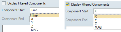

- Display Filtered Components: Used to filter true components. Some files list additional components (mostly Time), but those are not applicable. They can be filtered out.
