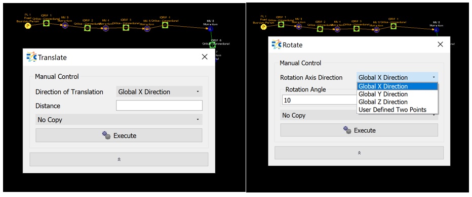

Translate & Rotate
Translate & Rotate operations relocate the positions of the objects either by dragging them through the Axis or providing Manual Control details.
Direction of Translation/ Rotation Axis Direction:
- Global X Direction
- Global Y Direction
- Global Z Direction
- User Defined Two Points
Either mouse location is tracked and first click fills in the Start X, Y, Z points, and second click fills in the End X, Y, Z points, or users should manually provide X, Y, Z points for Start and End.
Distance/Rotation Angle
If the first 3 options selected as Direction of Translation or Rotation Axis Direction, then the users should provide the distance or angle, respectively, to move the selected objects.
