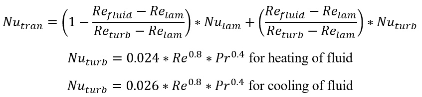

Lapides-Goldstein:

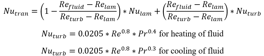

Dittus-Boelter:

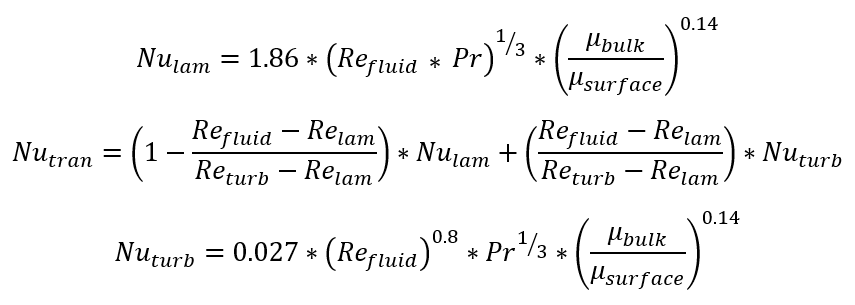

Sieder-Tate:

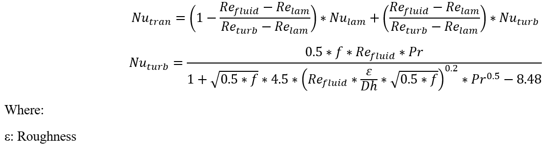

Gnielinski:

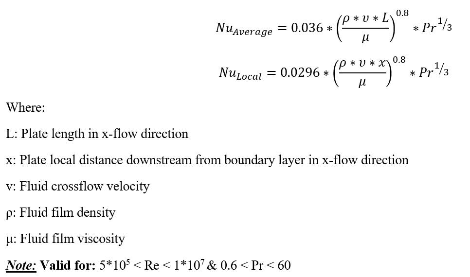

The following section lists cross flow convection and free convection configurations that
are available in Flow Simulator. These options are
primarily used by connecting a 1D Thermal Convection Resistor to an internal chamber
in the flow path.
Colburn (Plate in Cross Flow):

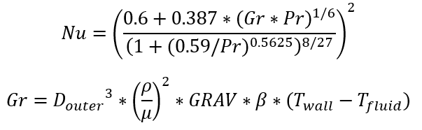

Churchill-Chu(Horizontal Cylinder in Free Convection):
Where:
Gr: Grashof number
Douter: Cylinder outside diameter
ρ: Fluid bulk density
μ: Fluid film viscosity
GRAV: Earth Gravity
β: Fluid bulk compressibility factor
Note: Valid for 106 < (Gr*Pr) <
1012

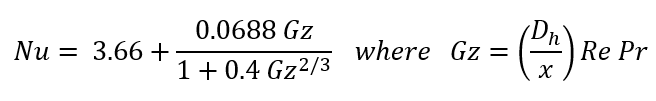

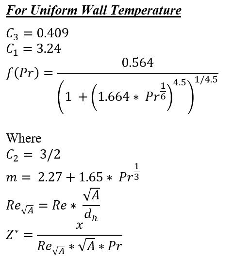

Laminar Duct Flow HTC correlations
The
following Laminar HTC options are available in Flow Simulator. It is worth noting
that Laminar HTCs depend on distance from inlet x, and thus do not need a special
Entrance Effects multiplier.

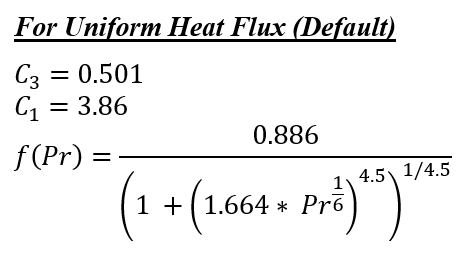

Muzychka-Yovanovich:
Hausen:
