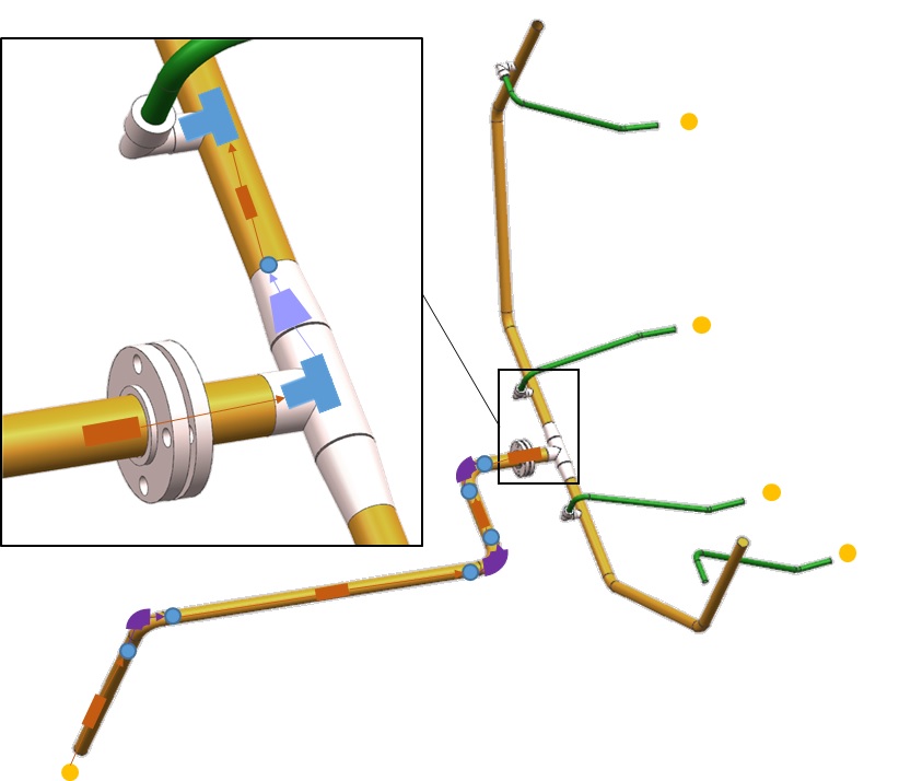

Step 1: Examine the geometry and create a plan
Create a model of a water piping circuit shown in Figure 1.
- The model begins with long runs of straight piping connected by 90 degree bends. It then splits in two directions and transitions into smaller diameter pipes, which feed four spray nozzles.
- To model this piping system, use the tube, bend, and junction elements.
- Use CAD to make most of the tubes and bends. The junctions are made manually. The elements around the junctions must be reconnected to the junctions.

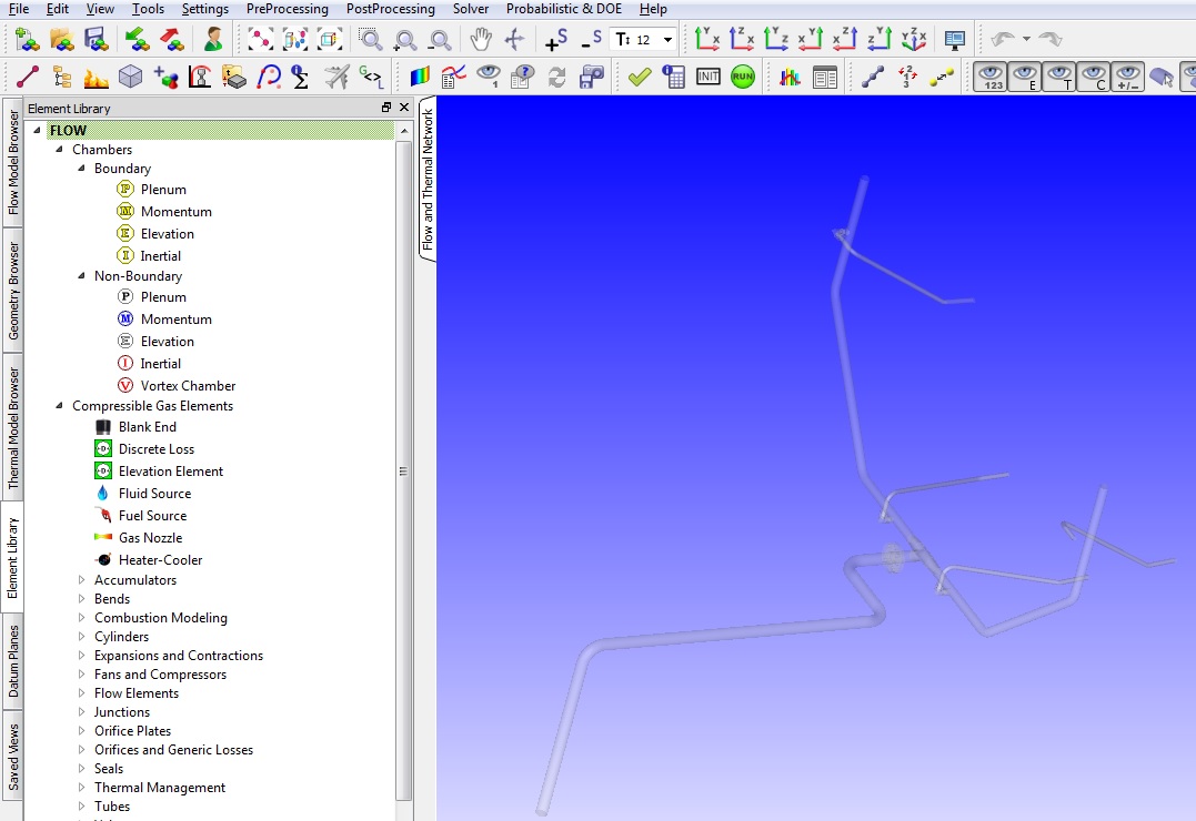

Figure 2. Loaded IGES on default background

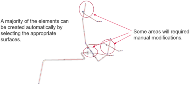

- Create tube and bend elements using the CAD geometry. Most of the tubes and bends
can be made quickly using the CAD. This method creates internal momentum chambers
for all elements, which you can change later. The main geometric inputs for the
tubes and bends are calculated by the GUI when using this option.

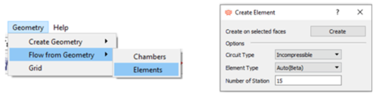

Figure 4. Menu options
Figure 5. Element creation using CAD

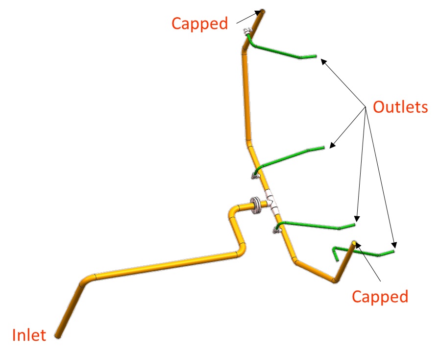

- Use

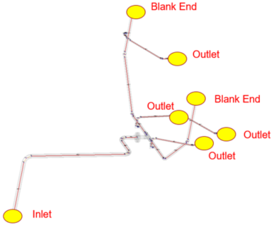

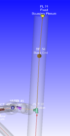

to adjust the symbol and text size. - Change the boundary chambers from internal momentum chambers to boundary plenum chambers.
Figure 6. Locations of the boundary plenum chambers
- Set the inlet plenum to a static pressure of 24.7 psi and a relative total
temperature of 70℉.
Set Material to water.
- Set the outlet plenums and blank end plenums to a static pressure of 14.7 psi and a
relative total temperature of 70℉.

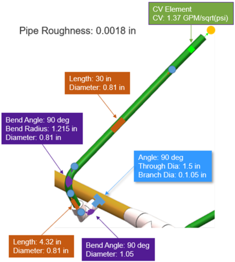

- Use multiple-edit to change the surface roughness of all incompressible tube elements to 0.0018 in. Do the same for the bend elements.

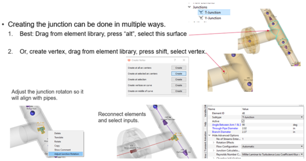

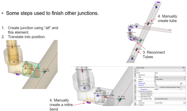

- Click and drag incompressible T-Junction elements to the pipe connection locations
shown in Figure 7.
Press Alt and pick surfaces close to the locations. Details
about creating the center junction are shown in Figure 8:
Figure 7. T-Junction locations
Figure 8. Center junction details
- Set up the spray nozzle as shown in Figure 9.
Figure 9. Nozzle model setup
- You created the tube and bend elements earlier. Change the last tube to a CV element
with CV=1.37 and FL=1.
Figure 10. Connect nozzle arms

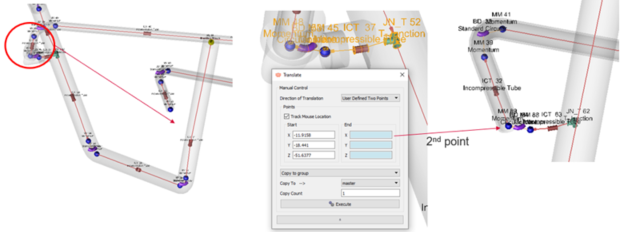

- One of the elbows leading to the nozzle is missing. Use the
Translate option to copy elements from a finished elbow
to this location.
Figure 11.
Figure 12. Use Blank End to cap the model

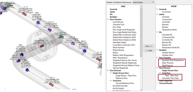

Step 5: Post-process
- The results file (*.res) automatically loads into the application. If not, use to select it.
- By default, the graphical workspace displays both chamber and elemental results.
- Use to customize the displayed results.Display the flow in GPM and the static pressure.
Figure 13. Results near Junction 1
