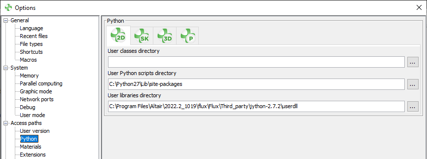

Configure Flux custom directories
Configure the Flux Supervisor options to use your UserDLL and UserLib folders for all Flux modules (2D, 3D, Skew, PEEC):
- Starts Flux Supervisor
- Open the Options dialog by clicking on the Options button in the bottom left
- Navigate to the options
- For every Flux application (2D, 3D, Skew and PEEC) enther the following
paths:
- User Python scripts directory :
C:\Python27\Lib\site-packages - User libraries directory :
%FLUX_INSTALL_DIR%\Third_party\jython-2.7.2\userdll
- Click Apply and close with OK
