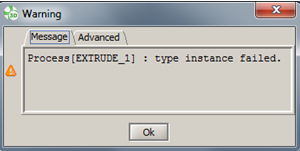

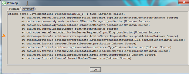

The dialog box returning the error message is composed by:
- A Message tab containing the user message part.
- A Advanced tab containing the technical info.
If the configuration is not managed in the code, in this case there will be no user error message but only a generic message "Failed execution"
| Example of an error message non-managed (so any user message) | |
| “Message” tab | “Advanced” tab |

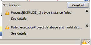

Warning management
The warnings are stored and accessible via the icon (bottom right):
By clicking on the icon, the warning list is unstacked.
Each warning is:
- editable by clicking on it
- can be deleted by clicking on
By editing the warning, a dialog box is opened with the user message.
The tab « Advanced » contains techniclal informations of the warning which allows givining necessary indications for the developer ,and the support team.
