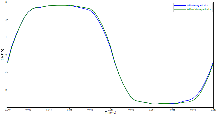

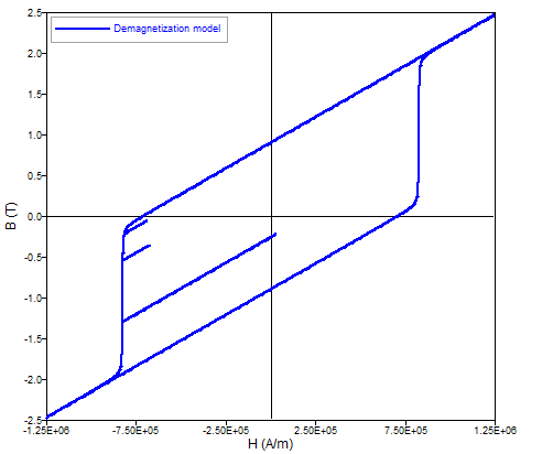

With this non-linear model, it is also possible to consider the demagnetization during solving (i.e. the irreversible degradation of a magnet's remanent magnetic flux density due to its interaction with a demagnetizing field) by checking the specific option that is provided during the material creation. This demagnetization model is based on a static Preisach approach and may apply in all quadrants of the magnet B(H) characteristic. The following additional remarks apply:
- Available for 2D and 3D in transient magnetic application
- In projects containing a magnet material with this option active, it is advisable to set the application to perform an initialization through a static calculation ()
- This model does not take in account temperature variations

Example of results
