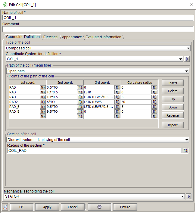

Help for creation
To facilitate the creation of composed coils (non meshed), several features are available in the creation dialog box :
- Insert a point in the list via the button
. - Delete a point in the list via the button
(after activating one of the cells of the
line to be deleted).The definition line of the point is fully deleted, i.e. the 3 coordinates as well as the curvature radius.
- Move a point up or down using the
buttons
and
(after activating one of the cells of the line to be
deleted). - Reverse the order of the points in the table using the button
(allows, among other things, to easily change the

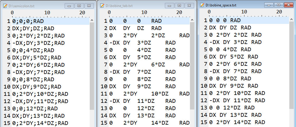

direction of the current in the coil). - Import a list of points contained in a TXT
file in order to fill the points table with the desired list of points
via the button
.If the table already contains points, the import will overwrite them all and replace them with the list of points of the imported file.
The file must contain 4 columns: the coordinates X, Y, Z and the value of the curvature radius. The separator can be:
- a semicolon
- a space
- a tabulation

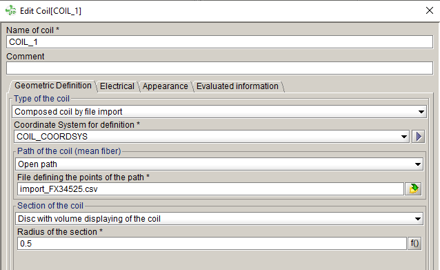

Composed Coil by file import
A dedicated type is available to create a composed non meshed coil directly by importing a csv file.
The CSV should be formatted as below:
- 1st column: X coordinate
- 2nd column: Y coordinate
- 3rd column: Z coordinate
- 4th column: curvature radius

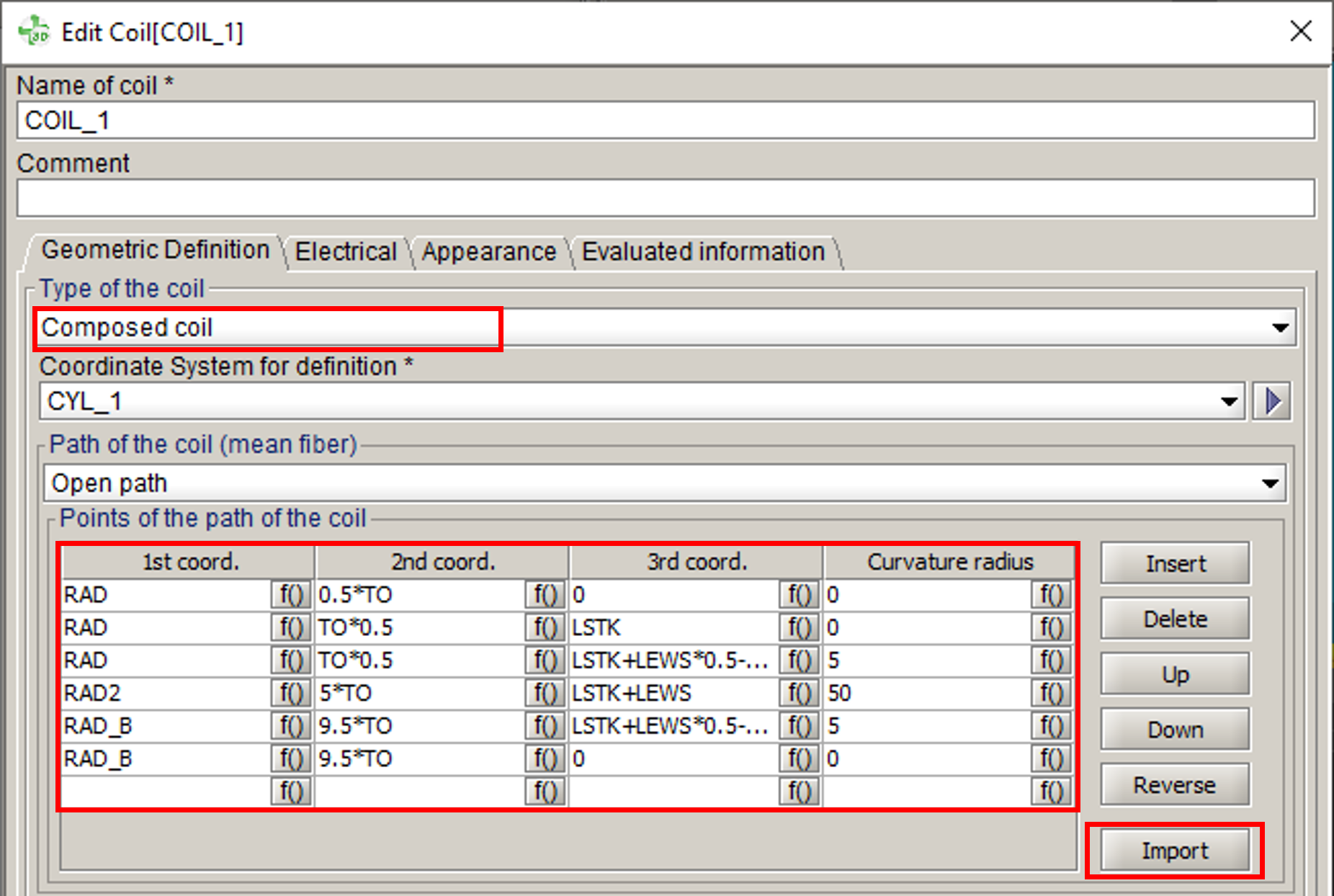

Difference between 2 possibilities of creation by import
It exists 2 possibilities of creation of composed non meshed coil by import:
- By using the Composed coil type + using the
"Import" button to fill the table with points informations,
contained in a txt file.Tip: Recommended for few points
- By using the Composed coil by file import type, with directly
a selection of csv file, without table in the dialog box.Tip: No limit of number of points. It's recommended when a lot of points are required.
| Difference between the both possibilities of creation of non mesh coil by import | |
| Composed coil + "Import" button | Composed coil by file import |
| Fill the table in the dialog box
No table in the dialog box
Limited number of points, because there is a limitation on the number of lines of a script python when it is executed. |
No limitation of the number of points, because the python command contains only the csv file, not all the coordinates of each point. |
The corresponding python contains the list of point with X,Y,Z
coordinates and the curvature radius.
The corresponding python contains only the csv file
