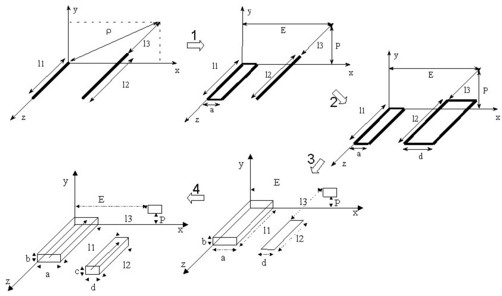

The final formula of partial inductance between volume conductors is obtained after four successive integrations as presented in the figure below.
According to the geometric configuration of the two conductors, for example if they are very distant, it is possible to stop the integration at various levels in order to obtain a less complicated expression (integration over the width or integration on the thickness).

Under further examination is the study of partial inductance between two conductors in the configuration presented below.

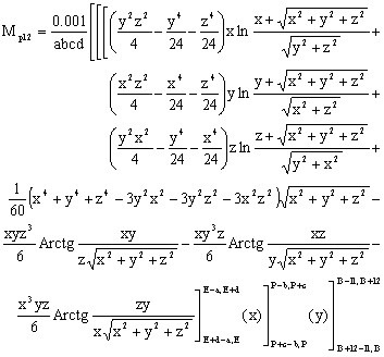

The analytical expression below gives the value of mutual inductance in µH if the distances are expressed in cm.
where:

The partial inductance of a volume conductor is a particular case. It is obtained by applying the previous formula with a = c, b = d, l1 = l2, l3 = 0, E = 0, P = 0.
