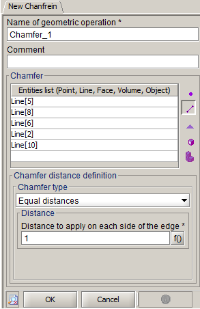

Creation of a chamfer on edge
The creation process of a chamfer on edge is presented in the table below.
| Stage | Description |
| 1 | Choice of the coordinate system of creation |
| 2 | Opening the dialog box Chamfer |
| 3 |
Choice of the name of the generated Geometric operation (by default: CHAMFER_1) |
| 4 |
Choice of entities on which the Chamfer will be applied
or
or
| 5 | Choice of the type of chamfer (equal distances or different distances) |
| 6 | Choice of the distance or of the two distances to apply |
| 7 | Validation by clicking on OK |
| → | A geometric operation CHAMFER_1 is created |
