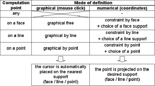

Note: * To capture points, the user may lean on one of the methods presented in the table below.
Parameter setting
The user can use geometric parameters to define the path by the numerical mode.
