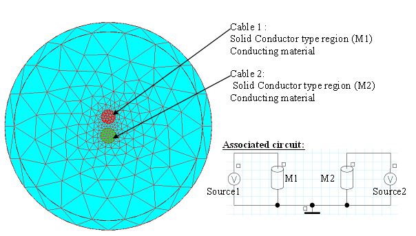

The example represents two cables, one supplied with sinusoidal voltage, the other with triangular voltage.
If the cables are placed close enough, there will be a electromagnetic influence of one upon the other, and the currents will not be perfectly sinusoidal or triangular, respectively.
Therefore, the purpose of the study is to regulate the current in the cable supplied with sinusoidal voltage to obtain a sinusoidal current.
Flux project
The geometry, mesh and physics are given below.

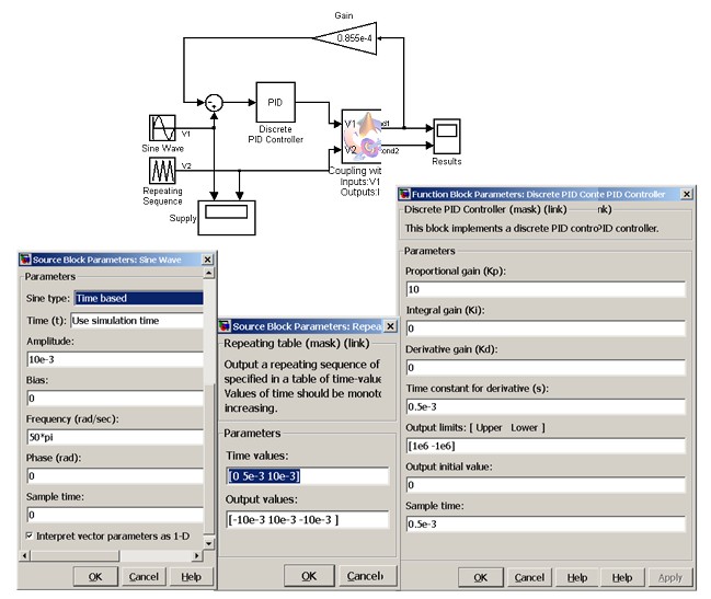

Preparation of the Simulink model
To prepare the Simulink model:
Step Action
1
Open Matlab:
  • Starting from the Flux supervisor in the Solve menu, click on Simulink
2 Open Simulink by clicking on
→ The Simulink library is open.
3
Make a new model :
  • Point on New and click on Model in the menu File
→ A blank window will appear
4
Register the model:
  • Click on Save in the menu File
  • Allocate a name (for example model_cables )
5
Place the section « Coupling with Flux »
  • Take the library « Coupling with Flux » in the library Flux_Link and place it in the window model_cables
6
Characterize the section « Coupling with Flux »:
  • double click on the section
  • in the tab Project:
  • allocate the name of the project CABLES.F2MS
  • tick or not Multiplexed inputs/outputs (in function of the desired representation)
  • in the tab Solve:
  • tick the case Automatic delay
  • tick the case Flux console display
  • validate the characterization of the library by clicking on OK
7 Place, characterize and connect the other necessary libraries according to the model in the figure below.
8 Save the model by clicking on Save in the menu File
→ The preparation of the Simulink model is complete

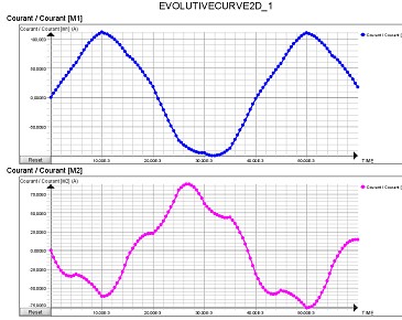

Analysis of results
The results can be analyzed in Matlab – Simulink, as well as from Flux in the project CABLESF2MS_SOLVED.FLU
Graph results in Matlab-Simulink Graph results in Flux
