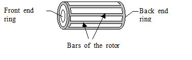

The squirrel cage of an asynchronous machine is an assembly comprising metal bars connected to one another, in cylindrical form, by two end rings. (see figure below).

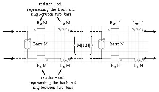

The electrical circuit of a squirrel cage contains the following components:
- a solid conductor for each rotor bar
- a resistor and a coil between either end of each of the conductors in order to simulate the end ring.
These pieces of information are represented in the figure below.
If N is the number of the bars of the squirrel cage, the electrical circuit contains N solid conductors, 2N resistors and 2N coils.

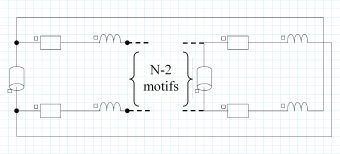

- cycling closing if the entire motor is described or if the considered part is physically symmetric to the neighboring parts (an even number of the poles are represented in the finite element domain),

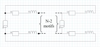

- anticyclic closing if the described part of the motor is physically antisymmetric to the neighboring parts (an odd number of poles represented).
The two types of the electrical circuit closing are represented in the figure below.
Cyclic closing: entire motor, symmetry (even number of poles)
Anticyclic closing: antisymmetry (odd number of poles pairs)
