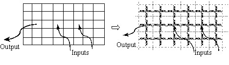

2D meshing
In case of a 2D mesh it is the plane of current flow that is discretized and not the depth of the conductor.
The conductor is split up into plane elements in which two privileged directions of current flow are considered.
In each of the four partial electric circuits associated to a plane element the current density is assumed to be uniform.
