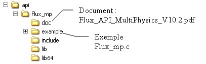

Information on the programming interface (API) for the multiphysics is placed in the Flux installation directory:
C:\Program Files\Altair\2018.0\api (standard installation by default)
There is the follwing information in the directory:
- a documentation on the multiphysics API (description of functions)
- an example (use of available functions)
