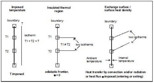

Interpretation
A graphic interpretation of boundary conditions is given in the figure below.
Important
The boundary conditions (heat flux, heat transfer, etc.) must be chosen correctly so that the quantity of heat entering can be discharged. Otherwise, the temperature may become infinite or it may decrease even below absolute zero. (See Balance of thermal exchanges / § Interprétation des résultats)
