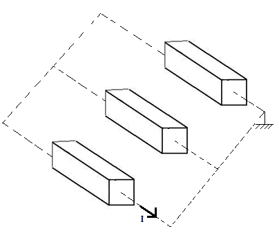

- a solid conductor which component is defined by the circuit (see image
below). For more information, please report to the "Circuit coupling"
chapter.
- a "No circuit" solid conductor which has no component defined in the circuit. In this case, the currents flowing in the conductors are only eddy currents. This page explains the "No circuit" solid conductor regions types which exist in Flux2D.

| Configuration | Choice in Flux |
The conductors are connected in parallel. The eddy currents flow into all solid conductors. Example: Squirrel cage of induction machine
For all the solid conductor regions to connect in parallel, choose: No circuit: Conductor in parallel with all others of this same type |
