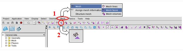

Activate the command
To activate the Mesh command, choose one of the methods presented in the figure below:
Note: It is possible to activate the Mesh faces / volumes command
without meshing the lines / faces. In this case, the line / face mesh will be
generated automatically and implicitly.
