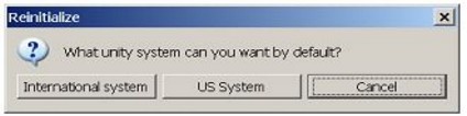

The following window will appear:
| 3 | Click on the desired system |
| 4 | Register the modifications carried out on the current dictionary by clicking on Save |
