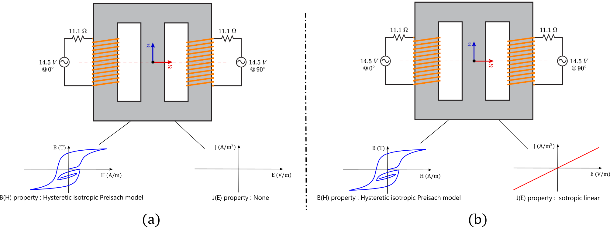

Let's consider once again the TEAM 32 problem presented in this page and let's use it to compare the evaluation of iron losses with the two previously discussed approaches, namely:
  • the static hysteresis approach: based on a material containing a Preisach B(H) property assigned to a magnetic non-conducting region;
  • the dynamic hysteresis approach: based upon a material containing both a Preisach B(H) property and a isotropic linear J(E) property assigned to a solid conductor region.
The application of these two approaches to the TEAM 32 problem is summarized in the figure below:
Figure 2. 2D representation of TEAM 32 problem with (a) the approach with a non-conducting magnetic region and a hysteretic B(H) property and (b) the approach with a solid conductor region, a hysteretic B(H) property, and an isotropic linear J(E) property.
The two voltage sources that feed the circuit impose a sinusoidal voltage with an amplitude of 14.5 V and a phase shift of 90° between these them. Several computations were performed, with the frequency of the voltage sources going from 1 to 100 Hz and with both approaches. The goal is to compare the hysteresis losses with the total iron losses for each frequency.
