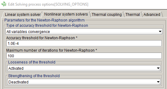

Newton-Raphson parameters and strategies are set automatically to ensure robustness and fast non-linear solving. It is nevertheless possible for the user to adjust these parameters, using the Nonlinear system solvers tab of the Solving process options box.
Adjusting of Newton-Raphson method
The user can adjust the following Newton-Raphson parameters:
  • Type of accuracy threshold: three options are available, namely:
    • All variables convergence: all variables of the system must satisfy the required precision;
    • Global convergence: the variable exhibiting the hardest convergence must satisfy the required precision;
    • Automatic.

  • The threshold: relative epsilon value below which Newton-Raphson non-linear solver stops. Depending on the activation of looseness and/or strengthening, this threshold is fixed or is the starting point of the adaptive criteria strategy. Default value is 10e-4.
  • Maximum number of Newton-Raphson iterations: the default value is 100.

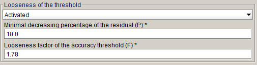

  • Looseness of the threshold: this adaptive criteria strategy is meant to ease hard convergence. The adaptation is based on the residual decrease between two consecutive Newton-Raphson iterations. If the decrease between these two residuals is less than a percentage P (default is 10%), we consider a hard convergence situation (Red region on Figure 1). If we have a hard convergence situation, the threshold is multiplied by a factor F (default is 1.78) to ease the convergence.
    Percentage P and factor F can be modified in advanced mode:

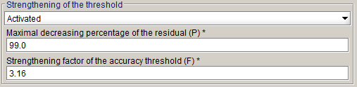

  • Strengthening of the threshold : this adaptive criteria strategy is meant to harden easy convergence. The adaptation is based on the residual decrease between two consecutive Newton-Raphson iterations.
    If the decrease between these two residuals is more than a percentage P (default is 99%), we consider a too easy convergence situation (Yellow region on Figure 1). If we have too easy convergence situation, the threshold is divided by a factor F (default is 3.16) to harden the convergence.
