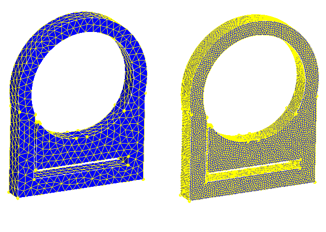

Mesh
- The mesh should not be too refined in order to take advantage of this new methodology without overloading the solver which needs to inverse a full matrix.
- Consequently, it is advised not to import the mesh from an external tool.
Figure 1. On the left, a good mesh for the integral method. On the right, a good mesh for finite element method.
