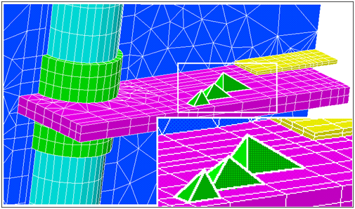

In 3D, the conformity with the interface between the meshed domains with hexahedrons or prisms, and the meshed domains with tetrahedrons is ensured by the automatic insertion of pyramid elements .
An example is represented in the figure below.
