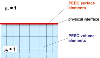

Surface currents contribution
Considering the surface artificial currents though requires the addition of supplementary subdivisions to the PEEC mesh, as the paths of the surface artificial currents are not known beforehand.
These subdivisions are of null thickness as they represent surface artificial currents, and they are present only on the external faces of magnetic conductor. The figure below illustrates this principle.
The PEEC model of a surface element consists in an equivalent controlled current generator having the following characteristics:
- the quantities that control the generator are the currents circulating in the
partial inductances of the PEEC volume elements. Indeed this generator must
contribute to close of the artificial volume currents
; - the control coefficients are connected to the geometry of the PEEC subdivisions. As the mathematic process for the calculation is rather complex, it is not detailed in this document;
- the equivalent generator is connected in parallel to the PEEC model of the adjacent volume subdivision.
