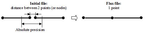

The absolute precision is the minimum distance between two points of the geometry (or between two nodes of the mesh) from which the two points (or the two nodes) of the initial file are represented by only one point in the Flux project.
The absolute precision is:
- either imposed by the user
- or automatically computed by Flux (automatic precision)
Automatic precision
The automatic precision, quantity automatically computed by Flux, is obtained by means of the following formula:
Absolute precision = Relative precision * Diagonal
