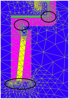

In the zones requiring a finer analysis of the studied phenomenon, this translates by:
- A tightening of the meshes
- A diminution of the finite elements size

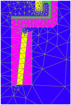

| No-adapted mesh | Adapted mesh |
