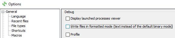

Binary save
To write files in binary mode, please follow these steps:
| Step | Action |
| 1 | Click on |
| 2 |
Click on Debug and not tick the case Write files in formatted mode:
| 3 | Click on OK |
| 4 | Open a project (or click on Start a new project) and save it. |

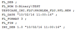

The project .FLU is saved in binary mode Here is an example:

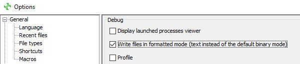

Formatted save
To write files in formatted mode, please follow these steps:
| Step | Action |
| 1 | Click on |
| 2 |
Cliquer sur Debug et cocher la case Ecrire les fichiers en mode formaté:
| 3 | Click on OK |

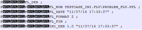

The project .FLU is saved in formatted mode Here is an example:
