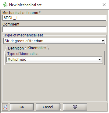

Create a 6 degrees of freedom mechanical set
- Open the dialog box of the creation of a mechanical set:
Click on
- Choose the name of the Mechanical set
- Choose Six degrees of freedom type
- On Definition tab, choose the Coordinate system
- On Kinematics tab, choose the
Multiphysic for the Type of
kinematicsNote: There is no choice, the Multiphysic type is the only choice (no coupled load or imposed position/speed for this type of mechanical set)
- Validate by clicking on OK

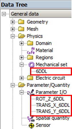

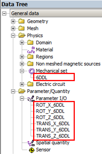

→ the mechanical set is created and displayed on the data tree
→ I/O parameters are automatically created ( six for a 3D project, and three for a 2D project)
Data Tree in a 2D project Data Tree in a 3D project
→ By default the parameters associated to the "6 degrees of freedom" Mechanical Set are multiphysic parameters. These parameters can be directly used:- in a coupling with an other software like Activate.
- in the multiphysic context of Flux
→ If you want to use a 6 degrees of freedom mechanical set directly in Flux, you should edit the parameter and change type from Parameter for multiphysical application to Parameter controlled by a scenario
