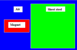

Example Create a new 2D magneto static project. This is a plan project, with a depth of domain of 50 mm.

Attribute the material to the faces region
Attribute the region to the face…
Create face region “ MAGNET ”, “ AIR ” and “ STEEL ”
Assign the material “ MAT_1 ” to the “ STEEL ” region …
Assign the material “ MAGNET ” to the “ MAGNET ” region …
For the magnet region, give a magnetic direction (following axis x…)
Assign faces region to faces…

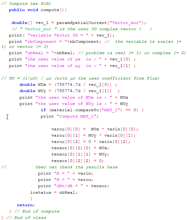

Click on the “ Edit user function ” to see and modify into the python editor the groovy sub routine “MaterialLaw.groovy”.
These files are in the directory: “....YOUR_FLUX_PROJECT.FLU\persistent\groovy ”
5
Type the following groovy (step 8) code in the sub routine public void compute (){} :
User parameter is paramSpatialCurrent“Vector_mur”. This is a double value type. The first component starts with the 0 pointer.
Note: In the key “Vector_mur” the first letter is writing with an upper case and the following, in lower case.

7 Solve the project
