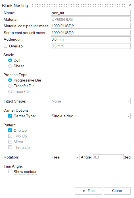

In the Blank Nesting dialog, define the blank nesting settings:
- Enter a run name.
- Enter a material and scrap cost per unit mass.
- Enter an Addendum (extra material on the periphery of the forming shape that serves to hold the blank during the stamping process).
- Select Overlap to enable the option and enter an amount.
- Select the Stock form.
- Select a Process Type.
- If you selected the process type Progressive Die, select a carrier option and patterns.
- If you selected the process type Transfer Die, select fitted shapes to use when fitting the blank and patterns.
- If you selected the process type Laser Cut, select the patterns.
- Select the amount of Rotation to maintain and nest, choosing from Free, Constrained, and Locked (manually adjusted rotation). If you choose Constrained, enter the angle of +/- freedom.
- Select Show contour to include trim angle visualization with the analysis.
Click Run.

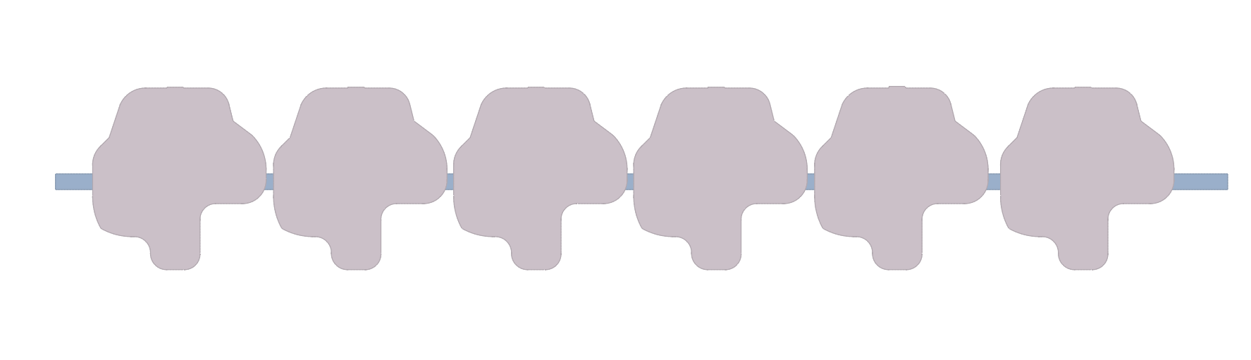

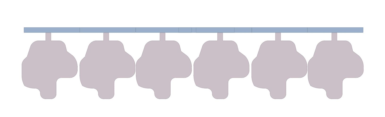

| Single-sided | The carrier is attached to one side of the part.![]() |

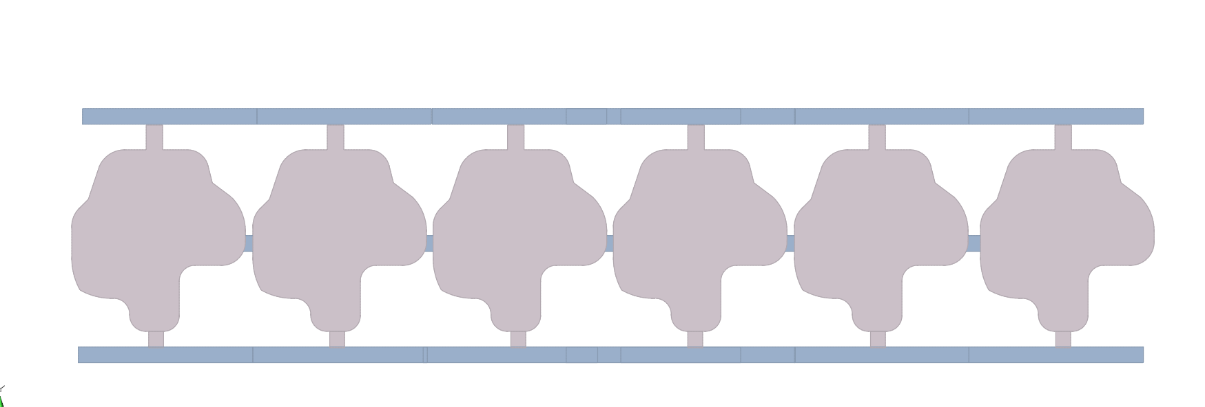

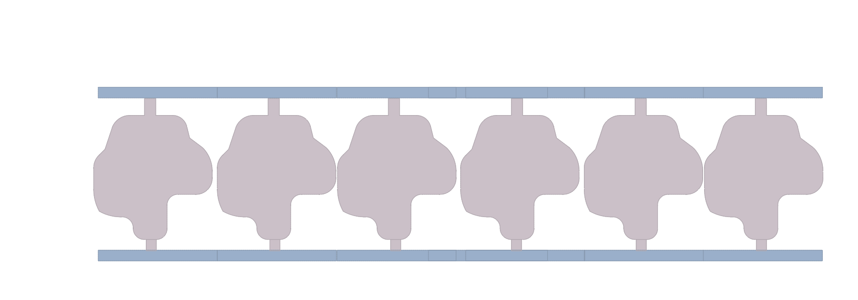

| Double-sided | The carrier is attached to both sides of the part. ![]() |
| Nested | The carrier is nested within the part. ![]() |

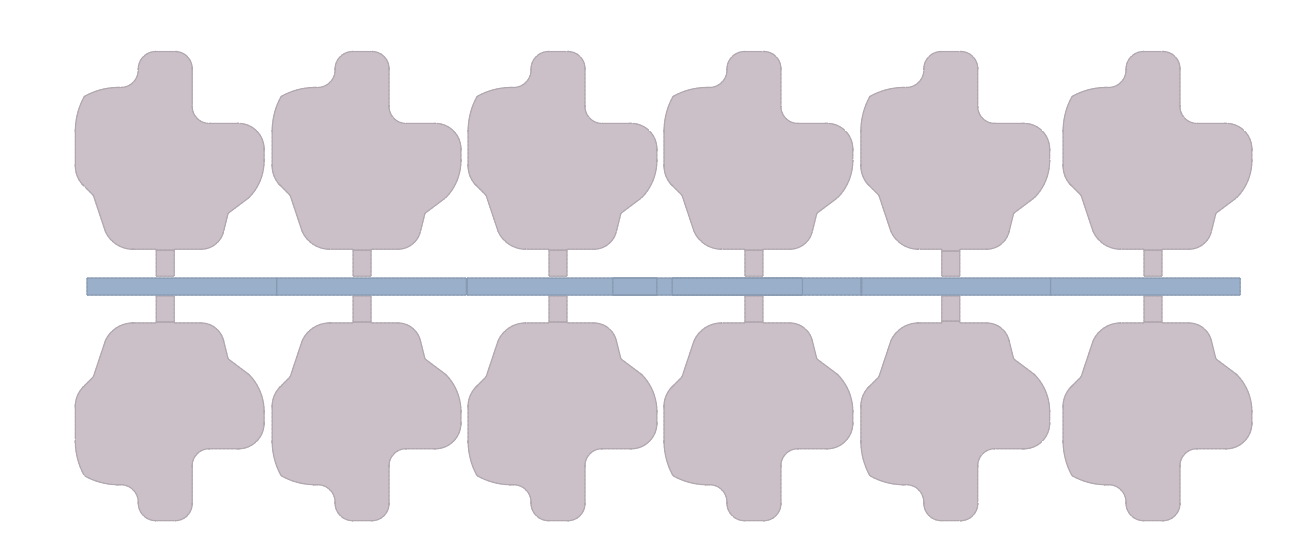

| Central | The carrier is in the center with the parts attached on both
sides. The parts mostly will be reflection of each other. ![]() |

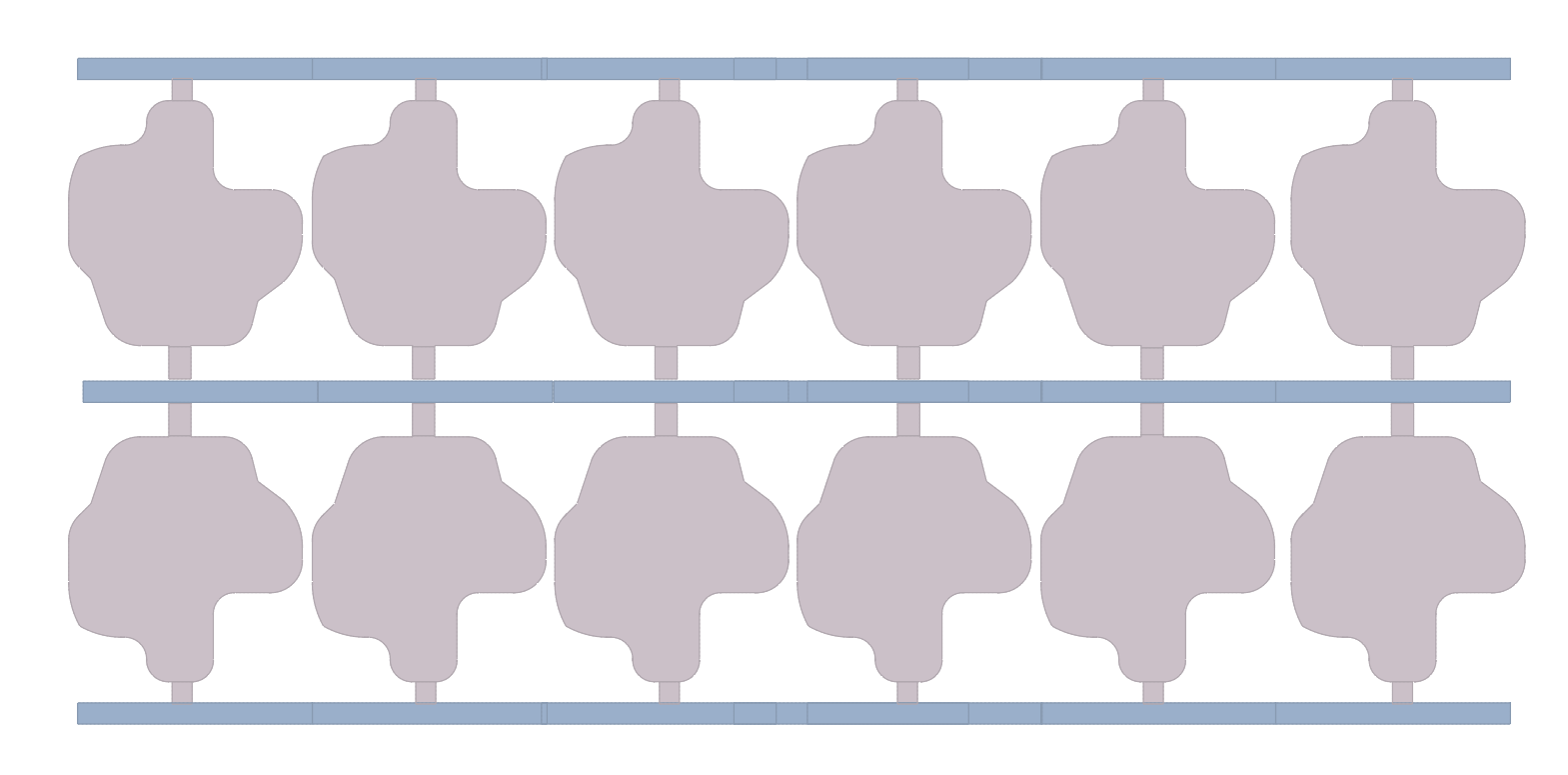

| Double-sided and central | The carrier is in the center with the parts attached on both
sides. The parts mostly will be reflection of each other. There is

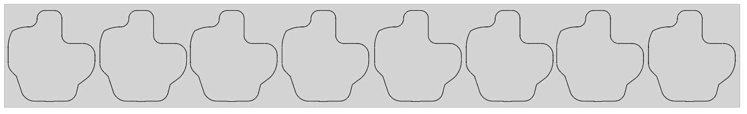

| One-up | This option allows you to nest one instance of the part on coil or sheet metal so that every stroke of press will produce a single part. ![]() |

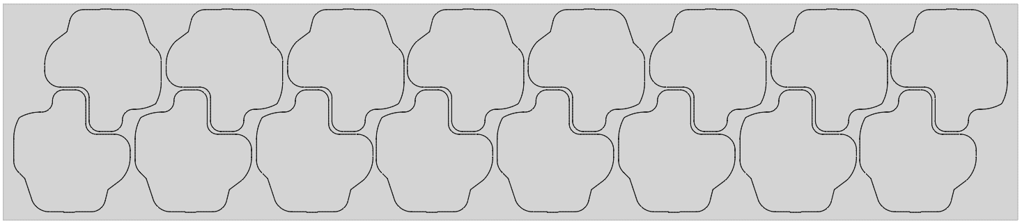

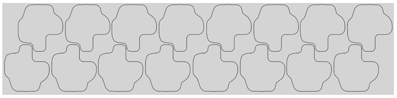

| Two-up | This option allows you to nest two instances of the part on a coil or sheet metal so that every stroke of press will produce two identical parts. ![]() |

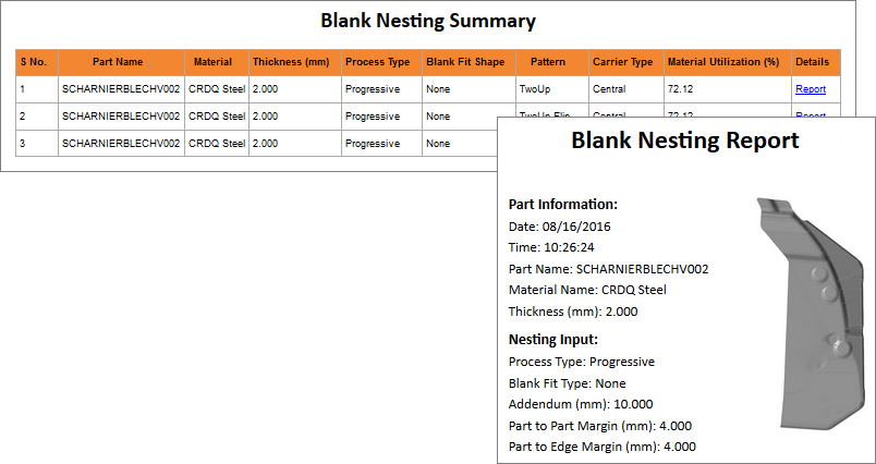

View Blank Nesting Summary
View the summary of a blank nesting.

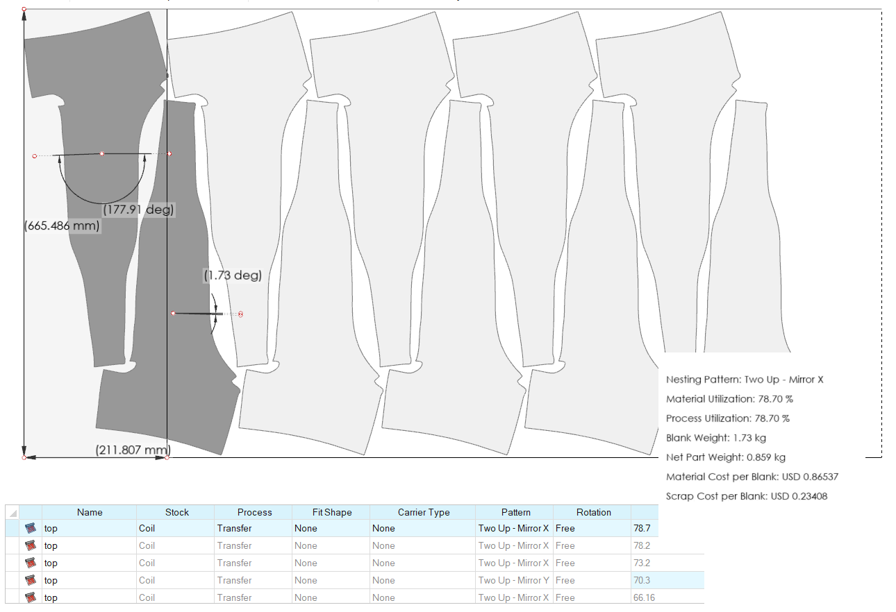

On the Feasibility tab, Nest icon, click the Show Blank
Nesting icon.
A summary of the blank nesting opens in Inspire Form. -
In the Nest runs table, click a run to view a table of
results from that run. By default, the most recent blank nesting is
selected.
Select one of the results to view detailed information.
Note: Blanks of tailor-welded parts are nested as two separate pieces.Note: Parts with a symmetry boundary condition are reflected about the symmetric plane, and and the entire part is nested. -

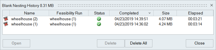

Blank Nesting History
View, sort, open, and delete past runs for the current and previous models.
On the Nest icon, click Run
History.
The run history is displayed.
Review the status of the run.
Status Description Note
The run completed successfully.
The run was incomplete. Some but not all of the result types may be available. You should run a new analysis to generate complete results.
The run failed and no meaningful results are available. - To view a run, double-click the row.
