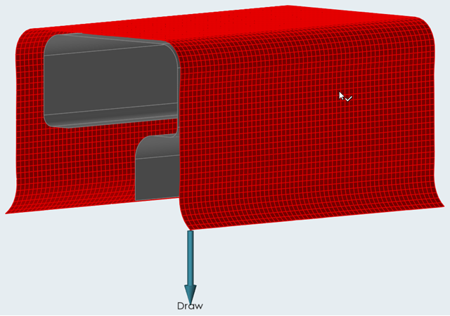

Define the Blank and Material
  1. On the Tryout tab, click the Blank icon.
  2. In the microdialog, click Single Blank for the blank type.
  3. On the model, select the blank.
    The blank turns red indicating your selection.
  4. To confirm the blank selection, on the model, select the blank again, or on the microdialog, click Assign.
  5. After assigning the blank, in the microdialog that appears, type in the material thickness and select a material of your choice for the blank.

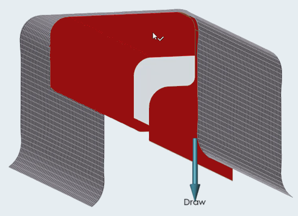

Configure The Bottom Die
  1. Select the Custom operation you added to your analysis.
  2. From the tool set for the Custom operation, select the Bottom Die.
  3. On the guide bar, choose Part.
  4. On the model, select the part to designate as the bottom die.
  5. Click to confirm the configuration of the bottom die.

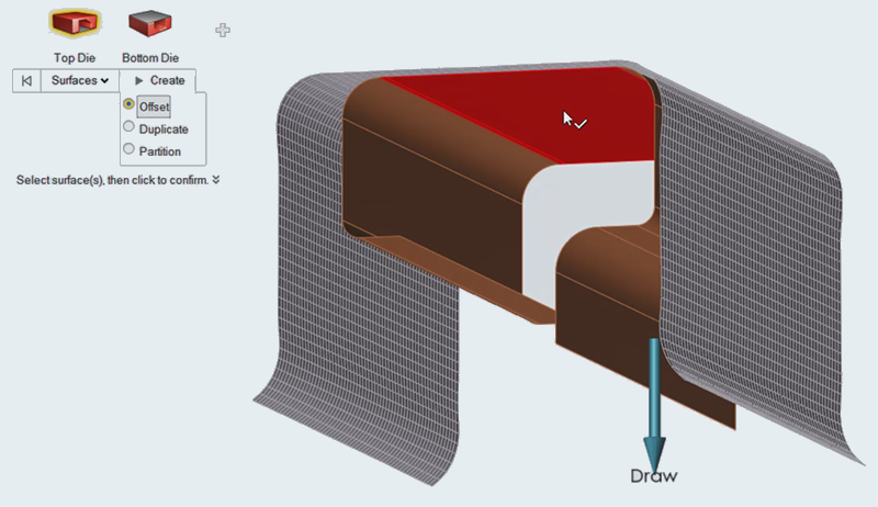

Configure the Top Die
  2. From the tool set that appears, select the Top Die.
  3. On the guide bar, choose Surfaces.
  4. On the model, select the surface for the top die.
  5. On the guide bar, for the surface, select Offset.
  6. In the microdialog, keep the default value 1.1836 mm for the offset. The default is the sheet thickness plus 20%.
  7. Click to accept the offset.

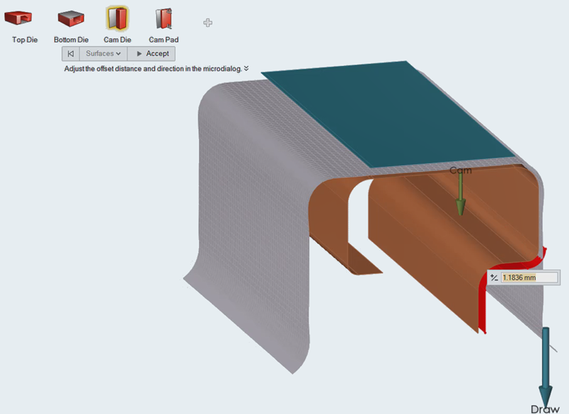

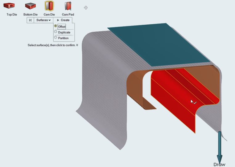

Configure the Cam Die
  1. On the ribbon, select the Cam Die you added to the crash form operation.
  2. On the guide bar, choose Surfaces.
  3. On the model, select the surface(s) to designate as the cam die.
  4. Click to confirm.

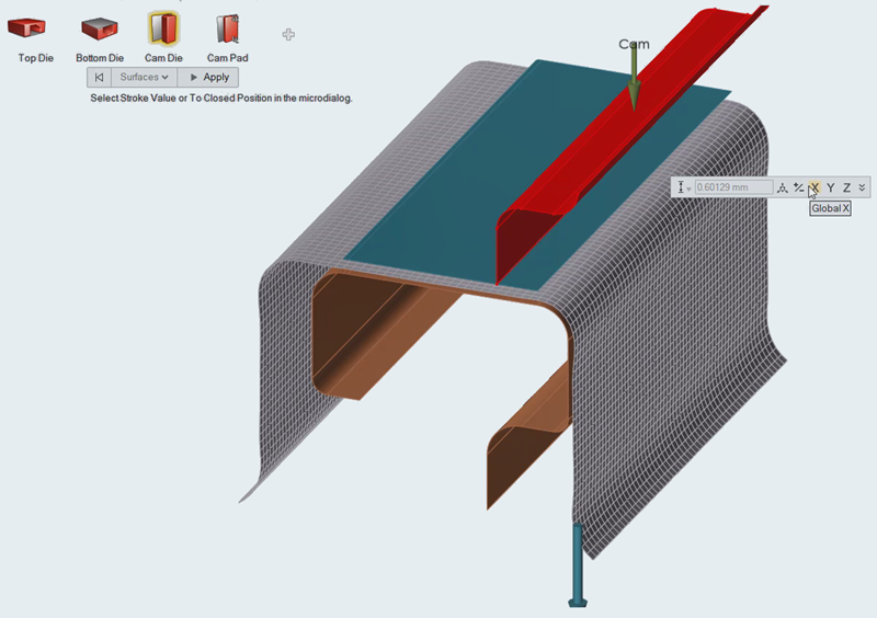

  5. In the microdialog, click the -/+ button to reverse the offset direction.
  6. For the offset distance, click to accept the default value, which is the sheet thickness plus 20%.
  7. In the microdialog, select Global X for the direction of the Cam Die.

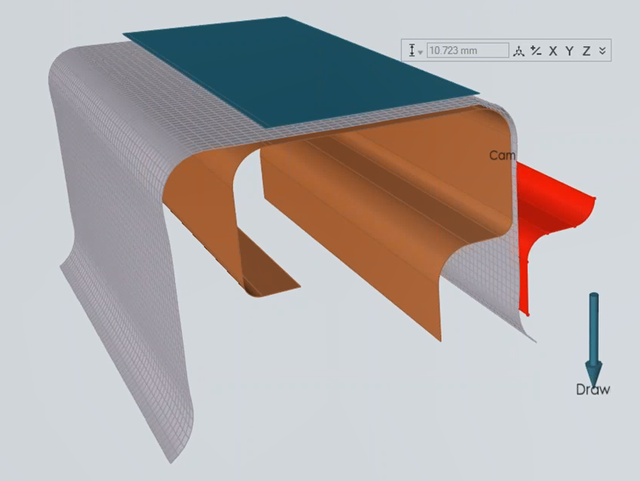

    Your cam die should look something like this:

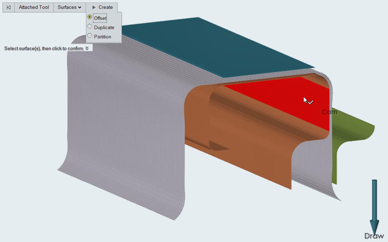

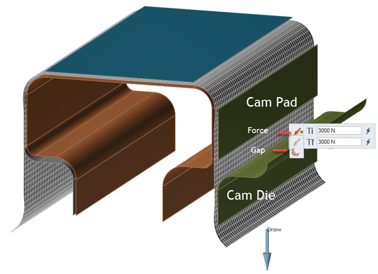

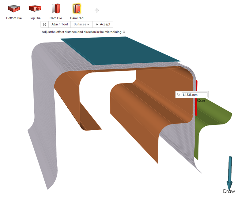

Configure the Cam Pad
  1. On the ribbon, select the Cam Pad you added to the crash form operation.
  3. On the model, select the surface to designate as the cam pad.
  4. In the microdialog, keep the default value for the offset. The default is the sheet thickness plus 20%.
  5. Click to accept the offset distance.
  6. In the microdialog, click the option to apply a Force. For the Initial Force and the Final Force, keep the default values.
  7. Click to confirm the configuration of the cam pad.

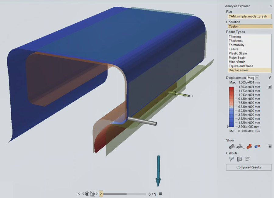

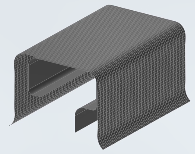

Review the Simulation Results
The Analysis Explorer lets you choose a variety of results to review. An animation for each result type is included. By default, the results for thinning are displayed on the formed part. The results below show the results for Displacement.
  1. With the slider below the model, you can review the forming of the model.
    • Adjust the results slider to see what areas on your model are under the greatest thinning.
    • To animate the results, click the play button. To jump to the first or last step, click the left and right arrow buttons, respectively.

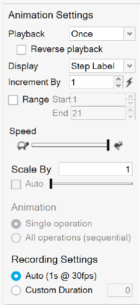

    • To adjust the animation settings for playback, display, or speed, on the slider, click .
  2. To view additional results, from the Analysis Exporer, select a Run, Operation, and Result Type.
